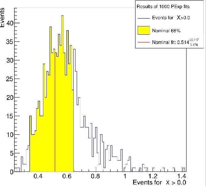

That's an example of a histo...
Try a Box-Cox transformation to make it more normal.
You should probably tell us what you are trying to do before using arbitrary transformations, test statistics and inferences.
Transforming data out of context is not a good idea and depending on what resolutions you are trying to make it can actually be detrimental to getting a useful inference.
What I wanted to do was to:
not add bins in order to find the +/- 34.1% errors to the red line, which can be binning dependent.
but instead fit a function on the distribution, and integrate that function around the red line to get the +/-34.1%.
Obviously the distribution is not Gaussian, but looks more like a Poisson...
I was thinking about rescaling the x-axis [since Poisson is accepting integer entries while I have floats], doing the fit, integrating, and then scale everything [together with the obtained variances] back to the original x-axis.
The point is that I have other distributions which look pretty much like Gaussians, and I wanted to make sure I could use a Poisson to fit them too [since the code should do that, I wouldn't want to check everytime the distribution and determine with what I could fit it with].
If you want to fit probabilities to data then that is understandable - but I ask because if it based on a particular process (of which the distribution constraints should be derived) then it means you typically construct models for specific reasons before you fit them.
I'd look at Gamma, Chi-square and other generalized distributions of these for more. You'll find they can deal with these bumps and skewness and you can estimate the parameters of these distributions and do goodness of fit tests.
