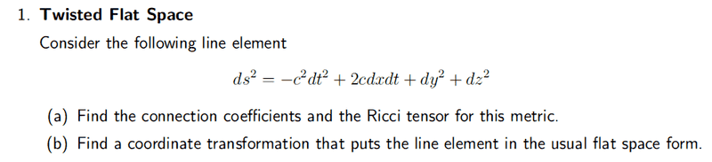

In summary, the homework statement asks for the christoffel symbols and the ricci tensor. I found the metric to be constant and found the transformation to the usual flat space form.
unscientific
1,734
[/B]
(a) Find christoffel symbols and ricci tensor
(b) Find the transformation to the usual flat space form ## g_{\mu v} = diag (-1,1,1,1)##.
Part(a)
[/B]
I have found the metric to be ## g_{tt} = g^{tt} = -1, g_{xt} = g_{tx} = 2c, g_{xx} = g^{xx} = 0, g_{yy} = g^{yy} = 1, g_{zz} = g^{zz} = 1##.
The christoffel symbols can be calculated by:
[tex] \Gamma_{\alpha \beta}^{\mu} = \frac{1}{2} g^{\mu v} \left( \frac{\partial g_{\alpha v}}{\partial x^{\beta}} + \frac{\partial g_{v \beta}}{\partial x^{\alpha}} - \frac{\partial g_{\alpha \beta}}{\partial x^{v}} \right) [/tex]
Since all components of the metric are constants, it means ##\Gamma_{\alpha \beta}^{\mu} = 0## and ##R_{\alpha \beta}^{\mu} = 0##.
Part (b)
I'm not sure how to approach this question. I know I have to find the Jacobian ##\frac{\partial \tilde{x^{\mu}}}{\partial x^{v}}##. I also know the transformation is ##\tilde{g_{\alpha \beta}} = \frac{\partial x^{\mu}}{\partial \tilde{x^{\alpha}}} \frac{\partial x^v}{\partial \tilde{x^{\beta}}} g_{\mu v}##.
Any input for part (b)?
For both the original line element and the usual flat space line element the metric components are constants. This suggests a linear transformation. So, maybe introduce a new time coordinate ##\tilde{t} = at + bx## where you can try to find values of ##a## and ##b## to do the job.
Letting ## c \tilde t = c t - x## makes it work because ##c^2 d \tilde t^2 = c^2dt^2 - 2ct ~dt dx + dx^2##.
Looks right.
