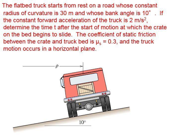

Flatbed truck going round a circular road on an incline
In summary, the student is having trouble understanding the algebra involved in the solution to the homework problem. They uploaded the solution to the problem, but are not getting the results they expect.
whdahl
The problem statement is in the attachments.

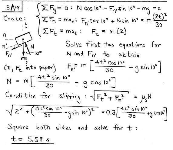

I uploaded the solution to the problem. I have had no trouble deriving the first two equations for the summation of forces in the x, n and t directions, however I am having trouble understanding the algebra involved in the solution, specifically where it says, "Solve the first two equations for N and Fn to obtain:", then it lists the equations for N and Fn. I can't figure out how they derived those two equations for N and Fn from the first two equations.
... they did exactly what was described - they too the first two equations... these were:
$$N\cos(10^\circ)-F_{n'}\sin(10^\circ) - mg = 0\\
F_{n'}\cos(10^\circ) + N\sin(10^\circ) = m\frac{2t^2}{30}$$ ... do you not know how to solve simultaneous equations?
