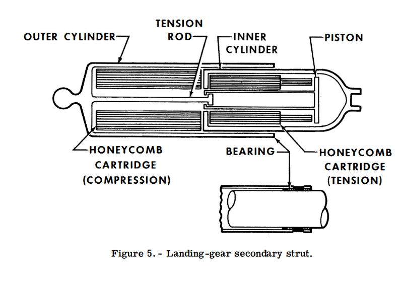

As I recall a similar honeycomb was used in the legs of the Apollo moon landers. I suspect it's just a matter of changing the shock absorber bit like you can do on a car.
Likes 1oldman2
CWatters said:
As I recall a similar honeycomb was used in thesuspension legs of the Apollo moon landers. I suspect it's just a matter of changing the shock absorber bit like you can do on a car.
Sure enough, there it is. In all the Apollo landings I have watched I had never considered the LM's suspension, thanks for pointing this out.
http://www.hq.nasa.gov/alsj/LM_Landing Gear1973010151.pdf
Likes mheslep
