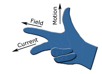

BruceW said:
And for the right-hand rule, you must use the current as your index finger, the magnetic field as your middle finger, and the force as your thumb.
Really?
Then what is this?

Picture in your last post is a right hand. And I see no contradiction with Bruce; what is your reason for the question mark ?
BvU said:
Well, you have now: See post #3 for the direction, ##\vec z \bot## both ##\vec x ## and ##\vec y##. Magnitude: |z| = |x| * |y| * ##\sin\theta## where theta is the angle from x to y.
I still don't understand.What is z,x and y?
What BruceW said:
What the picture says:
Picture said:
Index finger is the Field.Middle finger is the current
This is the question mark :wink:

Just tell me why that picture is wrong.
My textbook has the same picture too.Index is the field.Middle is the current.
Right hand is used to find the direction of current when a conductor moves in a magnetic field(Generator)
Left hand is used to find the direction of force when a current moves in a magnetic field.(Motor)
:confused:
It's not wrong in the sense that it is incorrect or something. But if you have to remember two things (left hand, right hand) in order not to mix up two other things (motor, generator), then all you do is shift the difficulty to not mixing up the two things (which hand was it again for motors ? for generators?).
If your textbook does it this way, you're probably better off just accepting it. I'm glad I didn't have to go ambidextrous ..
The Lorentz force is for charges in electromagnetic fields. "magnetic field" was in your OP (#). If you don't know about cross products, you certainly don't have to know about Lorentz transformations yet :smile:.
(#) coming back to that: maybe this two hand jumble uses this roundabout way to distinguish between one case where B and I cause F and in the other where F and B cause I. Really don't know.
adjacent said:
Really?
Then what is this? ...
the picture says index finger is field, middle finger is induced current, velocity (of the wire) is thumb. This is exactly as I said near the end of my post:

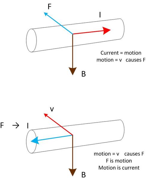

To keep a long story short I add over a Thousand words:
Big picture, big importance (imho)
Both pictures:
  • Positive ##x## direction is to the right
  • Magnetic field is down. Consider that the positive ##y## direction :smile:
  • Big arrowheads: in the ##x\, y## plane
  • Smaller arrowheads in the ##\hat z = \hat x \times \hat y## direction (a very simple cross product)
  • The coordinate system is right-handed
  • The Lorentz force is ##\vec F = q\, \left (\vec E + \vec v \times \vec B \right )##
  • There is no E field
  • Right hand rule: in ##\vec a \times \vec b = \vec c##
    a thumb
    b index
    c middle -- points in the direction of c​
  • Corkscrew rule: in ##\vec a \times \vec b = \vec c##
    turn ##\vec a## over the smallest angle towards ##\vec b## : Corkscrew goes in the direction of c​
Top picture:
  • We see a wire carrying current to the right. Current is moving charge. Moving charge has a "velocity".
  • We consider mobile positive charges in the wire :smile:
  • The Lorentz force is ##\vec F = q\, \vec v \times \vec B ##
  • All moving positive charges in the wire feel this Lorentz force
  • Together they "push" in the direction of ##\vec v \times \vec B ##
  • mutatis mutandis for moving negative charges: they move in the negative x-direction and the resulting Lorentz force points in exactly the same direction (- q x -v = +q x +v)
Bottom picture:
  • We see a wire being dragged in the positive ##z## direction with a velocity ##\vec v##.
  • Together they "push" in the direction of ##\vec v \times \vec B ##, which is the negative ##x## direction
  • This "push" is an electromagnetic potential (emf) that can cause a current.
That's all, folks!

yeah, I agree with BvU's pictures. Also, I think it helps to think in terms of each of the individual free charge carriers inside the wire. And this is explained by the Lorentz force law. I guess you don't really need to know about cross-product to understand the idea qualitatively. In the Lorentz force law, (using right hand) the motion of charge carriers is the index finger, the middle finger is the magnetic field, and the thumb is the force on the charge carrier.
p.s. note that I've used the phrase 'charge carriers', but specifically, I've been talking about positive charge carriers. for negative charge carriers, to use the Lorentz force law, you just reverse the direction of motion of the charge carriers. But in either case, if you are just given 'current', this essentially means "the direction of motion if the charge carriers were positive" So if you are given the current, you don't need to worry about whether the charge carriers are positive or negative. And similarly, if you are trying to calculate the induced current, due to motion of the wire, this does not depend on the sign of charge of the charge carriers.
So, in the case where there is no current in the wire, and we move the wire down manually, the charge carriers in the wire are moving downwards, and if the magnetic field is moving to the right, there will be a force on the charge carrier, which pushes it out of the screen, towards us. So there is an induced current coming out of the screen. And in the case when there is current going into the screen, and the wire has no movement, this means each of the charge carriers is moving into the screen, and the magnetic field is to the right, so the force on the charge carriers is down. But, the charge carriers can't move down, because they are inside the wire, so they force the entire wire to move down with them.
Likes 1 person
