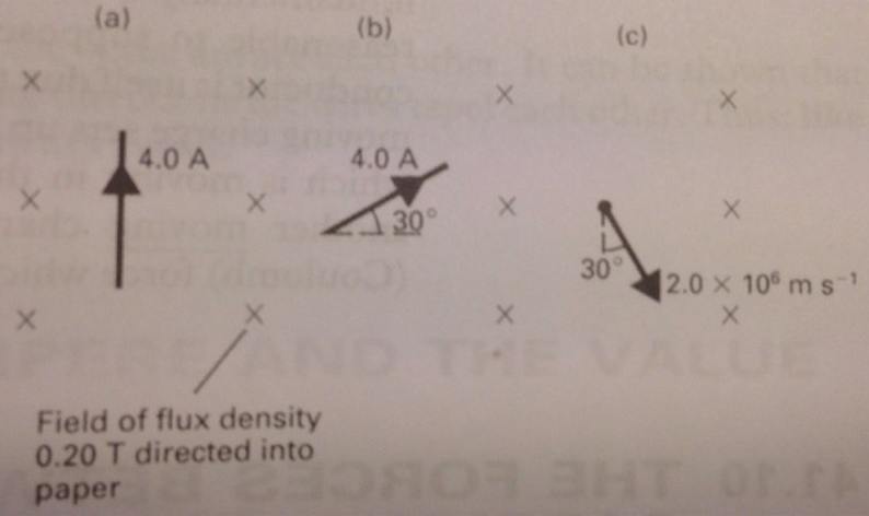

Diagrams (a) to (c) show a magnetic field of flux density 0.2 T directed perpendicularly into the paper. In each of (a) and (b) a conductor of length 0.3 m is entirely within the field and is carrying a current of 4 A in the plane of the paper. In (c) an electron is moving in the plane of the paper at 2 * 106 m/s. Copy the diagrams and show the direction of the force in each case. Also find the magnitude of the forces. (Charge on the electron = 1.6 * 10-19 C.)

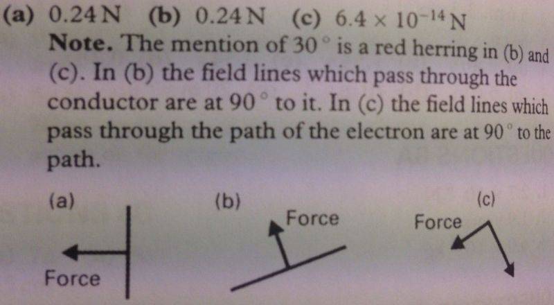

Answers:

(a-b) F = 0.2 * 4 * 0.3 * sin 90 = 0.24 N
(c) F = 0.2 * 1.6 * 10-19 * 2 * 106 * sin 90 = 6.4 * 10-14 N
The (a-b) graphs we get using the Fleming's left-hand rule. For (c), however, I get the force directed in the opposite direction (to north-east, not south-west). I think this is because (in constrast to (a-b), where there was current in each case and not particle) the particle is directed downwards and thus is negatively charged, so we need to change the middle finger from south-east to north-west. But I'm not sure about that. Any ideas on (c) graph please?
If an electron is moving down and to the right, which way is the current?
Likes moenste
The opposite way, so upwards and left. And having this using the left-hand rule we get the correct answer. Right?
Yes.
