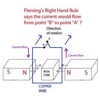

Electrical Fleming's "right hand rule" is not working for me. Why?
The DIY generator built with a toroidal coil and two north pole magnets is producing only erratic readings of around 500 millivolts, contrary to expectations based on Fleming's right hand rule. The discussion reveals that the magnetic flux is not effectively confined within the toroid, leading to minimal output. It is emphasized that a complete magnetic circuit is necessary for effective generation, and without a counter-winding, the coil behaves as if it has only one turn. The participants suggest that the external magnet's influence on the internal flux path is insufficient for generating consistent voltage. Overall, the design flaws and misunderstanding of magnetic field interactions are identified as key issues affecting performance.

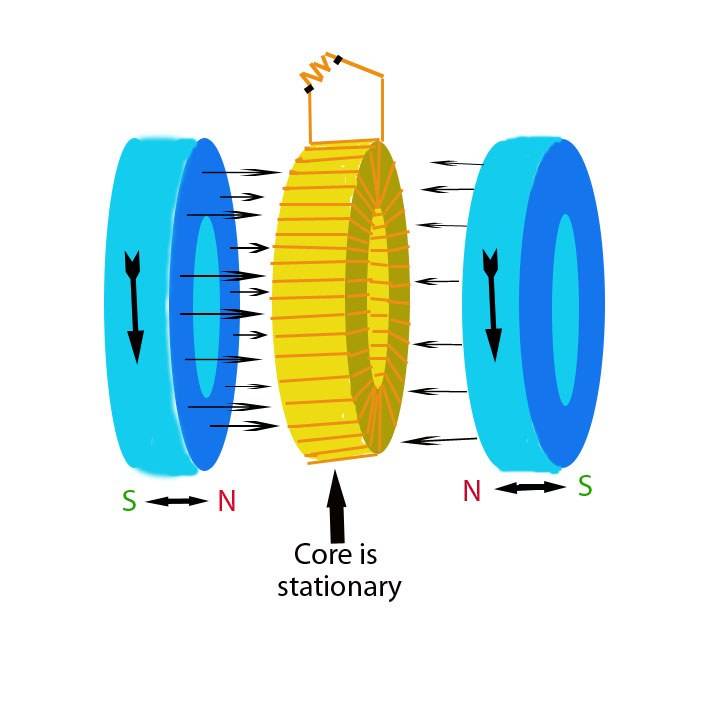

I built this DIY generator on the thought that the flux from two north poles of a magnet would be attracted to an iron core of a toroid coil. I wrapped the 4 inch OD toroidal coil with about 700 turns of 27 awg wire. The toroid coil is stationary with the magnetic flux rotating around the coil. I've only been able to produce about 500 millivolts with it being very erratic. DC in one direction for 1 second then the other direction for a second or two. Switched the voltmeter over to AC and I get a reading of 400 to 500 millivolts. I don't know why it doesn't work. According to "Fleming's right hand rule" it should...but doesn't. I'm attaching a simple drawing showing the principal of it. I must be violating some law of physics so if anybody here could point it out I would appreciate it. It's driving me crazy.

Welcome to PF.
The circular magnetic field inside the toroid is generated by the external winding. The magnetic fields outside the toroid cancel.
It is only the one loop of the helix coil around the toroid that generates an axial magnetic field. If you feed one connection back round the toroid, even that will disappear.
Thanks very much! I needed an answer. It was driving me crazy. So I'm understanding from this that a toroid coil would not work for generation but only transformer application. Another thing that I didn't mention was that I also tried this with north field on one side of the toroid and south on the other & rotated each in opposite directions still complying with Fleming's rule but with the same result.
Again thanks so much! I have some other ideas to move on to without a toroidal coil.

I’ve been giving this more thought and I understand that a toroid coil locks the flux inside the coil. In the illustration I have a “N” pole on each side of the coil. I believe the magnetic dipoles inside the toroid coil realign themselves with “S” poles attracted to the two external “N” poles with opposing “N” poles in the center of the core. It seems like this would create DC without brushes or slip rings. In the lower left corner you can see the setup. As I said in the first post I was only able to produce erratic AC and DC at 500 millivolts. I have since purchased a galvanometer to get a better idea of what is happening in slower time. Starting from the top of the coil (position of leads) I moved a single magnet counter clock wise producing 2 to 3 millivolts negative until I reached the half way position on the coil (180 degrees). It then reversed to 2 to 3 millivolts positive until I reached the top again. This explains the AC reading but doesn’t tell me why. The coil is wrapped completely in one direction. It is NOT a bucking coil.
Where the two N poles face each other their fields tend to cancel. If the field is cut by the coil then it must exit the core above and below, cancelling.
You need to draw each closed magnetic field line with arrows, from the N pole to the S pole, so you can see where the two separate magnetic fields will sum, and where they will cancel.
Unfortunately, you cannot generate DC without a slip-ring, a commutator, or a rectifier.

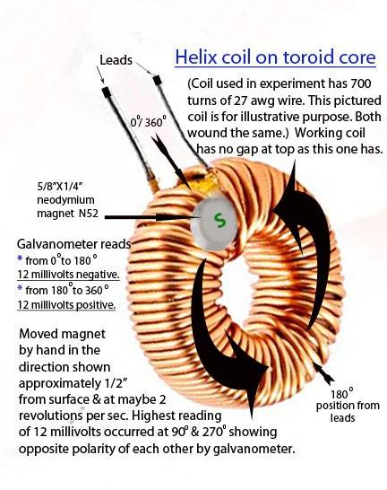

I see now that it is as important that the magnetic circuit be complete (or closed) as is the electrical circuit. Mother Nature is very hard to fool. I still don't understand why I get a couple millivolts potential in one direction starting from the leads of the coil and then a couple millivolts potential in the opposite direction at exactly 180 degrees on the coil? I move the magnet at about 1 inch increments and watch the galvanometer deflect negative 1/2 cycle then positive the other 1/2 cycle. It's a 4 inch diameter coil so the flux is not spilling over from the 5/8 x 1/4 inch magnet.
There are so many variables undefined, or that may have changed in your experiment, that I have no idea what you are really doing. There are three possible axes that you can rotate something 180° about. In which direction are you moving the magnet? Which magnet?
When you write "The coil is wrapped completely in one direction. It is NOT a bucking coil." I have to wonder if it is a simple helical winding on a toroidal core, with the leads running parallel. If that is the case then it is actually a one turn coil the size of the toroid, which might explain the few mV you are seeing.
You need to do simple experiments until you can predict correctly what will happen. Even then you will find things that do not at first appear to be rational.

I’ve attached another illustration to hopefully better explain where I’m at in this & what I am doing. As I said earlier I am using a 5/8” X ¼” single magnet and rotating it in a counter clock wise direction. I failed to mention I was holding the magnet in my hand & also that it is an N52 neodymium magnet. I didn’t want to mechanically power the original configuration with 26 of these N52 magnets as I was getting 400 to 500 millivolts and would have blown out the galvanometer. Sorry about mentioning that it wasn’t a “bucking coil”. I had read that a “bucking coil” were two separately wound coils on the same core that opposed each other. Maybe they’re only used in transformers but I added that information so that you or anybody else reading this would know it was not & not the reason for the AC output. Yes, it is an helical coil with 700 ampere turns of 27 awg wire. As far as rotating around the axis, I was meaning the face of the toroid coil. Maybe that’s the “Y” axis, I don’t know. I do know that it’s not the top or the inside of the toroid coil so if it was a tire I would call it the sidewall. I followed the link you provided for information on Faraday’s Paradox. I spent hours reading about it and the theories offered. Seems the theory that the magnet was contaminating the brushes, wire and equipment is what stands. I thought that was the answer to my problem but rechecked today & moved the magnet all around the leads and equipment with only the slightest vibration showing on the galvanometer. What I did do differently today was to not rest the magnet on the face of the coil & push it an inch at a time. I held it about ½” off the coil and rotated it around the face. The illustration gives all the details. Thank you for your time & thought, Mike

@MDG You are kidding yourself that you have 700 turns on the toroidal former, being influenced by the external magnet. Believe it or not, you actually have only one turn, hence the very small signal.
The internal flux of your 700 turns is not completely confined to the core. That is because you fail to counter-wind one terminal wire back around the core to cancel the one turn of the coil axis about the circumference of the toroid.
Look very closely at fig 4 and fig 5. Do you notice the white counter turn?

You are still missing the critical point. Amp·turns are irrelevant and distracting.
The 700 turn winding has almost no external field. The flux is almost all internal. The EXTERNAL magnet is NOT coupled to the toroid's INTERNAL flux path.
Why “almost all” and not “total” ? Because the axis of the coil is effectively one circumferential turn around the outside of the toroid. A “counter turn” cancels that axial turn and totally confines the flux to the toroidal core.
You are seeing only the effect of the magnet on that one external turn.
