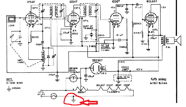

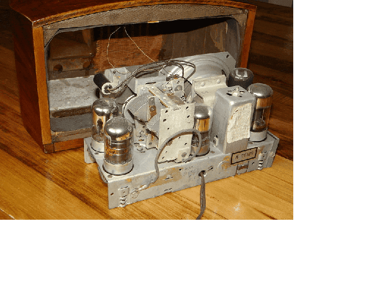

Hmmmm, well, sometimes.
Two prong plugs nowadays have one wide and one narrow blade so they'll only go in one way but that was not always the case.
Those old radios from 1930's to 1950's , the cheap table models in plastic or wood cases often were wired as you suggest.
They were called "All American Fives" because they all used the same 5 tubes.
To make them cheap they didn't have a power transformer. One side of the line cord was tied to chassis, and the enclosure was supposed to keep you from getting shocked. Before 1950's the plug was not polarized and could go in either way, so the chassis might be connected to either hot or neutral.
http://en.wikipedia.org/wiki/All_American_Five
Potential hazards of the design
Many early examples of the 'All-American Five' posed a shock hazard to users. Lacking a mains transformer, the chassis of the AA5 radio was directly connected to one side of the mains electric supply. The hazard was made worse because the on/off switch was often in the wire of the mains supply which was connected to the chassis, meaning that the chassis could be "hot" when the set was either 'on' or 'off', depending on which way the plug was inserted in the power outlet. Many power plugs had two identical pins, and could be plugged in either way round. The metal chassis securing screws were sometimes accessible from the outside of the Bakelite or wood case, and there were many examples of owners receiving a shock by making contact with these screws while handling a set. Ventilation holes could be large enough to allow children to poke their fingers, or metal objects, through. The same type of hazard was present in European AC/DC sets, at twice the voltage.
Better equipment like quality console radios and TVs always had a hefty power transformer that isolated chassis from house power.
