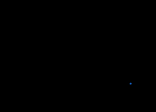

Ok very much amateur here, appreciate any advice.
So, the guy at home depot suggested the ballast was the reason my flourescent kitchen light goes out occasionally. The light worked well for the first 3 years of ownership. Now, it doesn't buzz or flicker, it just occasionally doesn't work.
After some time, it will work fine again. Anyway, home depot says change the ballast, here's what you need. Seems simple enough, I remove the old ballast and then realize that the wiring diagrams are different.
Here is the old:
And here is the new:
So basically, on the yellow end of the bulbs, I need to put two bulbs in parallel (instead of all 4). And on red/blue ends, one wire goes to each bulb, and then the two prongs are in parallel instead of a separate wire going to each individual lead.
Here is my question:
The old yellow end is wired like this:
I'm just wondering if it's ok to wire up one end of the prongs only, as is done here, or if it was previously wired incorrectly, and instead the yellow wires should go to each prong as is shown in the wiring diagram.
Thanks in advance for the patience regarding my dumb question.
That should be fine.
However, the original ballast heated the filaments in the lamps, allowing them to start at lower ambient temperatures, and operate longer into their end-of-life. If they need to operate at low temperature (50°F ?), get an exect replacement ballast, one that has two leads to at least one end of all the lamps.
If you need the heated filaments, it might be easier to find two ballasts, each operating two lamps.

Thanks everyone for the advice. I had already purchased the ballast, so gave it a go, and the lights worked fine.
But...
The old ballast housing did not fit over the new ballast, and I got frustrated and decided to try the LED suggestion. Wiring up the LEDs to bypass the ballast entirely was easy and seemed like a good idea.
But...
The lights worked fine and looked good, but there was a very faint humming/buzzing sound. After googling, this issue seems to mostly be related to lights that are on a dimmer. However, mine are not on a dimmer. On the installation instructions that came with the LEDS, it says very specifically "if there is any buzzing, contact an electrician."
I do not think that the wiring in our house is very old, but there are some other indications around the house (shoddy plumbing, etc.), that the previous owner was a bit of a DIYer, and maybe not great at it.
What do you all think? Thanks again for all the advice.
