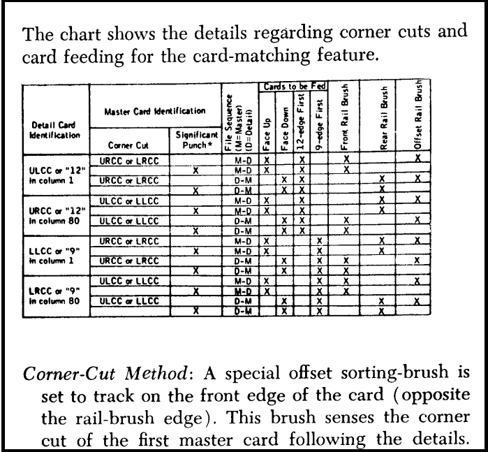

sysprog said:
The corner cut was there to ensure that the card reader could tell when a card had been placed in a wrong position for reading.
Not exactly. The card readers did not look for that cut. But the key-punch operators, computer operators, and programmers did.
By "card readers", I am including all manner of card reading devices: High Speed card sorters; 400-series accounting machines; reproduce punch machines; key punch machines; as well as computer card readers.
If you wanted to keypunch onto the back of the card (perhaps because you wanted to read the blank side), you could do that as long as you fed that card into the various card reading devices the same way. Of course, if you weren't the one actually feeding those cards to the machine, you would need to alert the computer operator to your deviant preference.
I worked with Data General, Honeywell and IBM card handling equipment. So there might be exceptions among Buroughs, Univac, NCR, CDC, and digital.
In general, card readers were not allowed to be picky. A lot of those cards were cycled through the target population (students, employees, applicants, teachers, administrators, ...) before being read. Those cards often came back with fairly creative damage.
Hey guys: Some of this information has been hanging around in my head for 50 years waiting to get out.
Likes Klystron
The corner cut was definitely observed by the equipment for checking card orientation. From a 1967 http://www.textfiles.com/bitsavers/pdf/ibm/cardProc/A24-1034-3_82-83-84_sorters_Dec67.pdf:
