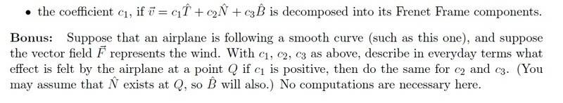

My next question is a bonus question. I'm just reading up on this now but if someone could kind of give me an intuitive grasp on the ideas related to the question, that'd be great. Mainly my question is the one above, not so much the bonus (though I could really use the marks).

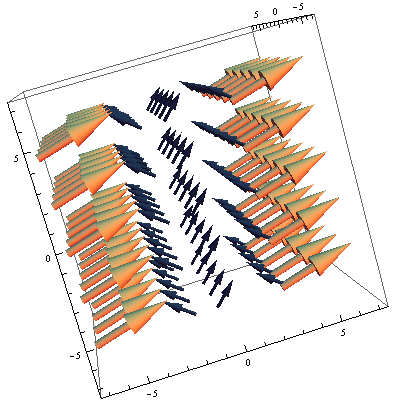

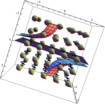

I will help you with a couple o'plots:
First: Plot of all flow lines / you got that right /
Second: Plot of all flow lines + plot of the equation which runs through the point (0,3,2)
