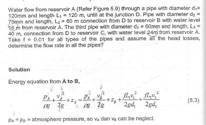

the author stated that Q1= Q2 + Q3 , that's means the water flowing from reservoir A to B and C ...
why can't Q1 + Q2 = Q3 ? which means water flow from reservoir A and B to C ?
We don't know why, becuz you didn't include the figure which the problem refers to. :frown: o_O

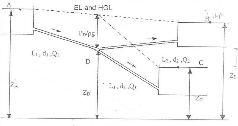

Look at the diagram for this problem.
Concentrate real hard.
Now, ask yourself what is the difference between Q1 + Q2 = Q3 and Q1 = Q2 + Q3?
Likes foo9008

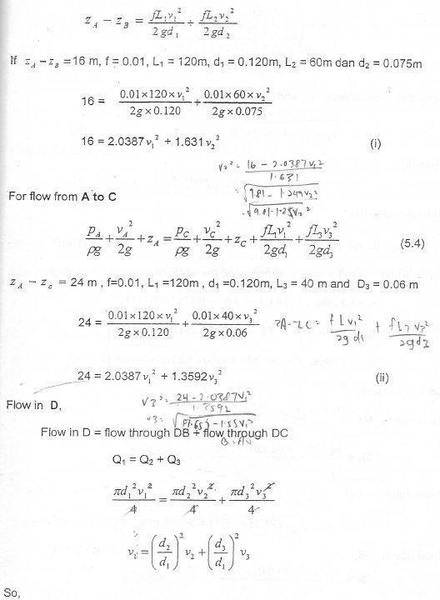

Q1 + Q2 = Q3 means the water flow from reservoir 1 and 2 = reservoir 3 ... Q1 = Q2 + Q3 means the water flow from reservoir 1 = reservoir 3 + 2
Now, do you want to take another try at answering the question you posed in the OP?
Likes foo9008

foo9008 said:
i still don't understand why can the water flow from reservoir A and B = reservoir C , which means (Q1 + Q2 = Q3 ) since the water can flow from high to low level , reservoir 1 and 2 are higher than 3 ...

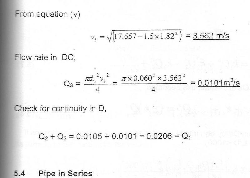

No, you're not looking at the diagram closely enough.
In the diagram, ZA > ZB and ZA > ZC. When ZA is higher, there will be flow out of Reservoir A.
The pipe leading out of Reservoir A splits at point D. By continuity, the flow into the split at D from Reservoir A must equal the flow out of the split into Reservoir B and Reservoir C.
Mathematically, Q1 = Q2 + Q3, which is the continuity equation written for the split at D.
How much flow occurs depends on other factors.
Likes foo9008
since ZA and ZB > ZC , why can't the water flow rate from A and B equal to C ? I'm confused...
btw , Q1 = Q2 + Q3 means the water flowing out from A equal to water flowing out from B + water flowing from C ?
Or the water flowing out from A is equal to( the water flow from A to B + water flow from A to C )
i assume Q1 = Q2 + Q3 means the water flowing out from A equal to water flowing out from B + water flowing from C ? am i right ?

foo9008 said:
i know that the ZA is the highest , so the water would flow out ...But , at junction D , water from reservoir B will also flow out to junction D , am i right ? since B is higher than D
But, in order for water from Res. B to flow to the split at D, it must flow against the pressure in the line created by the flow from Res. A.
You can't look at these flows in isolation. You must look at the entire network system.
Likes foo9008

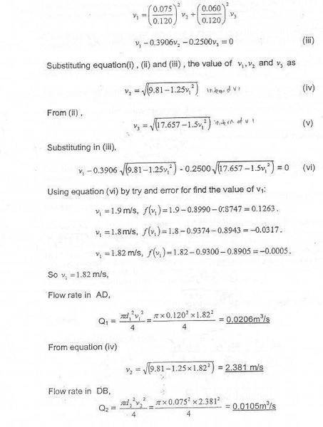

can anyone explain why the iteration stop at v1 = 1.82 , where f(x) = -0.03 , shouldn't the iteration stop at f(x) = 0 ?
It's not clear what you are talking about here.
If you look at 138.jpg, middle of the page, v1 = 1.82 m/s and f(v1) = -0.0005. That seems to be zero for all practical purposes.
The only way to reduce -0.0005 toward zero is to add more digits to v1, which may already be at the limit of its precision, given the accuracy of the original data provided in the problem statement.
so , f(v1) = -0.0005 is accurate enough for exercises?
It's accurate enough for most things.
You are free, however, to keep grinding away at these calculations, adding more zeroes to f(v1), but you are not going to come up with a completely different answer than v1 = 1.82 m/s.
