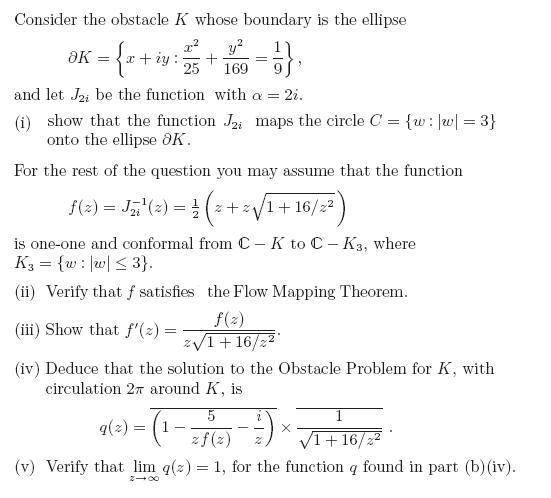

Hi All
I have one final question that's related to flow problems with obstacles.
Any help would be greatly appreciated as I am finding fluid flows extremely difficult.

Hi All
Think I've cracked part (i) and (ii). However, I'm stuch on part (iii). I think I need to use the Inverse Function Rule somehow to get the function stated but when I do, it doesn't give the answer. Can someone please help? The inverse function rule states that f (z)'=1/1-1/(f(z))^2.
Dont know if it will help but for part (ii) I got z+(4/z)-(16/z^3)...
Please please help...
There is something missing! You say "let [itex]J_{2i} be the function with [itex]\alpha= 2i[/itex]". I presume that somewhere earlier they defined another function [itex]J_{\alpha}[/itex] but you don't include that information.
The function you specift is given by the following formula:
Jalpha=w+(alpha)^2/w.
Hence j2i=3+4/3 and j2i = 3-4/3. Substituting this into the standard equation of an ellipse for a^2 and b^2 and rearranging gives the required formula. Does this help?
