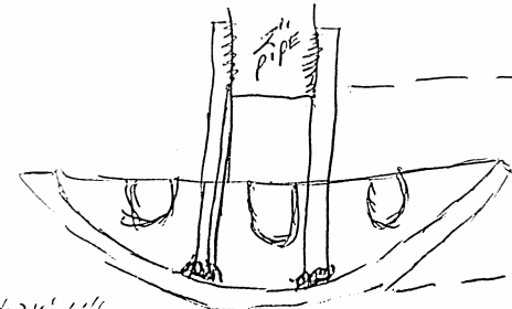

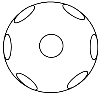

I think I understand what you are asking, but to make sure, please add a diagram. Is the purpose of the side holes to make jets of water? If so, indicate on the diagram how far the jets are supposed to jet. Indicate any constraints (15 to 91 cm is a constraint).

Top-down view of the bowl I know the original post specifies 8 holes, but this is a stand-in I have on hand.
Side view of the assembly (note: the two vertical pieces that extend from the pipe to the bowl itself are supports attaching it to the ceiling, welded on either side of the center hole, 1.27 cm in diameter).
Constraints:
The fluid is water at 82.2 C, density 0.97056 g/cm3.
The inner diameter of the pipe is 19mm, and the outlet flow is 1.324 m3/min.
The diameter of the bowl from edge to edge is 20.32 cm, and the depth is 2.54 cm, though I'm looking to change that, eventually.
Each hole around the circumference needs to shoot a jet out ~2.4 m horizontally. The distance from the holes to the bottom of the chamber is ~6.86 m.
The center hole is 1.27 cm in diameter (though I'll be looking to vary this eventually), and there are no specifications for the diameter of the side holes.
Apologies if I've over- or underspecified any part of this. I'll be available to answer any questions as they pop up. Please let me know if any further clarification on the design of the system is needed.
I appreciate any help you can provide in regards to modeling the system.

1) If your plate needs to shoot streams of water a specified distance both horizontally and vertically, you need to do some calculations. A jet of water will exit the plate perpendicular to the plate at the hole. You calculate the velocity necessary to hit the target point. This is just the cannon ball calculation found in every physics book. Then you calculate the head of water needed to get that velocity from Bernoulli's equation. The flow rate through that hole is velocity times area times the orifice coefficient. Then iterate the plate design as indicated, and repeat the calculations until you have a finished design.
