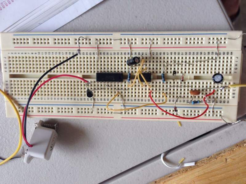

Hi Baluncore,
I checked everything again. Few points that I observe and few things that I want to ask.
> The diode blow up earlier could be due to the reason I placed capacitor with reverse polarity, corrected it now if it was a case.
>I bend the pins of CD 4017 (1-7), so that they don't contact on breadboard, leaving 8 , the ground pin.
I tested everything with led with a resistor as you said. Strangely the buzzer is going when I don't ground the CD 4017, however as soon as I connect 8 pin to -ve the buzzer stops.
I have connected the flow switch without the flow and buzzer is going on, which it should be. I will try tomorrow with the flow to see how the circuit goes with pulse input.
Can you please advice why no. 8 pin is a issue for cd 4017. I am attaching a better resolution pic for you.
Many Thanks
Looks good.
The flow pulses are very sharp, and maybe very powerful. They are not like normal CMOS logical signals.
You must fit the 1k to 4k7 resistor in series with the capacitor in the flow pulses input before the diodes.
4017 Pin 8.
The 4017 is a CMOS digital counter. It needs a DC power supply to function. That requires two wires, one, a low voltage called Vss, Vee or Vdd, and another, more positive called Vcc. The low voltage supply, which is also the reference voltage for the signals is pin 8. The +ve supply, is pin 16. Those supply pins should not be disconnected while the circuit is running.
The 555 also has power supplies, but to pins 1 and 8.
I recommend that you test it without the flow pulses connected. You can momentarily connect the 4017, pin 15 = reset; to 4017, pin 16 Vcc. That should stop the buzzer. Once the link is removed, after a delay of a few seconds, if all is OK, the buzzer should sound again.
With the prototyping board you are using, it is quite OK to plug in N/C =”not connected” pins.
You just do not plug links into the connector strips for those pins marked N/C, ignore them.

Hi Baluncore, I replaced cd4017, but still no joy. This is last circuit. I did debugging and there no signal out from pin 11 and 13. However again if I don't ground 8, there is a continuity and buzzer/led goes on. But with the flow its not stopping. 555 output is pulsing I checked. Thanks
Keep the 4017 pin 8 grounded. Removing it will cause more problems and never help to diagnose the problem.
Read the data sheet on the CD4017 until you understand how it should behave.
During testing, flow pulses will be a distraction. So pull the flow sensor completely.
You will do much better with a short test link between pins 15 and 16.
With the link in place, the buzzer should stop.
With the link removed, or pin 15 connected to 0V, the buzzer should sound after a short delay.
Does that happen ?
Hi Baluncore, there is no voltage out from pin 11 13, when pin 8 is grounded. The buzzer is not going atall even after both steps you asked. Thanks
I do not trust the daisy chain of ground links along the bottom left of the components.
Link directly to the 0V ground rail whenever possible.
It looks like you may have grounded and shorted the 555 timing capacitor and hence pins 2 and 6.
But that might actually be the capacitor – lead to ground, there is insufficient resolution to see clearly.
The 555 timing capacitor can go directly between pins 1 and 2 without any links.
The 555 timing resistor can go directly between pins 2 and 3 without any links.
The 555 output(3) can then be linked directly to the clock(14) on the 4017.
So why is the 4017 not counting up?
Measure the voltage on 4017 state “0” = pin 3, if that is high, it is staying in the reset state.
That can be because;
1. There is no clock reaching clock pin 14. Or;
2. You have checked that the inhibit pin 13 is low.
3. Reset(15) is stuck high or is noisy, maybe 100k not pulling to ground?
Ground reset(15) to 0V with a direct link. Does that make a difference?
