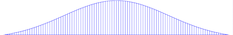

Consider a water droplet on a frictionless horizontal plane, subject to gravity. The cross-section of the droplet would look something like this (water volume at any given position along the cross-section discretized into water columns):

This conclusion agrees with our previous observations: with a frictionless surface (μ = 0) we get h > h' which is what we found at the beginning of the post (water will only be transferred if the receiving column has less water than the "donor" column. Note I ignored the fact that the water spreads to more than one column (probably four) since we are in two dimensions, but it should just be a constant factor on the (h - h') term - but I haven't checked. With this relation and some integration, it should be possible to compute the steady-state height and water distribution of the droplet depending on its original height, its initial water distribution and the surface friction.
Now my question - is this actually correct? It seems to make sense to me, and the results seem to be coherent and consistent with experiment, but can anyone check through my work and see if they agree with it? Does it make sense, is this what is actually happening physically or are there extra things to consider?
I also have an extra question: this analysis ignores surface tension as the droplet's surface area changes - how important are those effects and what would be the first step to introducing them into the equation? I am unsure how to calculate the effects of surface tension - my first idea was to consider the change in (h - h') after the water has moved, which is what is causing the droplet's area to change.
Thanks in advance :)
Friction is not an issue with a fluid because of the well-known no-slip boundary condition at a solid surface. This is a fluid mechanics problem, and viscous forces play a major role. For this particular problem, surface tension effects are also very important. Surface tension affects the pressure distribution within the fluid, which feeds into the viscous flow. Another factor consider is the contact angle at the interface between the solid, liquid, and gas, which is determined by the chemical nature of the three materials (primarily the liquid and solid). The contact angle is typically not zero. Non-stick surfaces have lower contact angles.
So, if you are going to start modeling this problem properly, you need to forget about friction, but include viscous flow, surface tension, non-slip boundary condition, and contact angle.
In this problem, because of the very thin nature of the fluid film on the surface and the slow velocity of flow, fluid inertia is not significant, and the behavior is dominated by the creeping viscous flow equations. The Euler equations do not apply to this situation.
