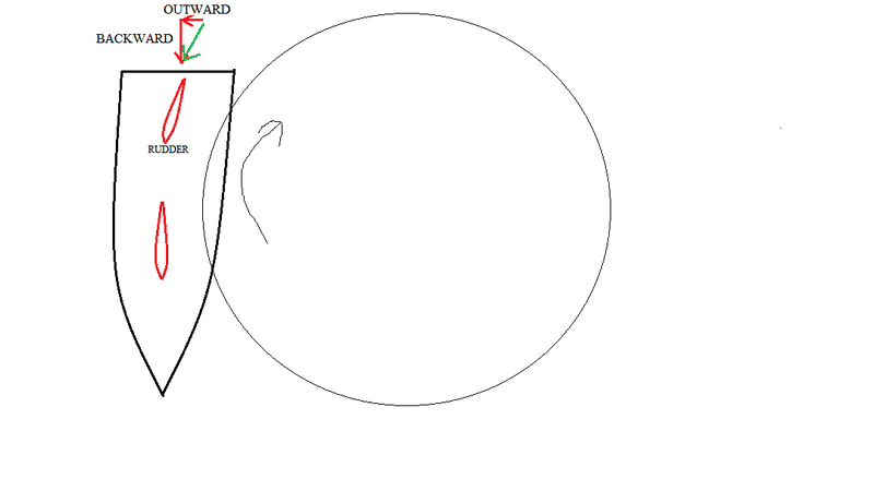

1. Is it possible that sailing boat(going backward) turns less when rudder is full right, then rudder is at some smaller angle?
Due to too high AoA and flow separation/stall, trailing edge of rudder is sharp that also lower stall AoA...
2. Analysis waterflow when object move at curved path.
Can I show flow at rudder with backward component because boat moves backward plus outward flow due to boat rotation around itself?

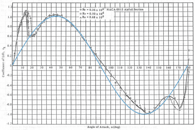

Yes, as you said, the rudder can stall and produce less "lift" than when it has attached flow.
Any vector (water flow field in your case) can be expressed as a sum of independent vectors that span the space. Usually we like to make them orthogonal, as you have.
foil produce approx same lift at 45° AoA as at max AoA, but has drop between two..
Trailing edge of rudder is sharp so rudder will stall at low AoAs, I think even lower than 8°, so from this theory you must use only small rudder angles if you want to steer "hard" this is opposite from human practice in cars..
Lift must point perpendicular to boat centerline for max steering, that also mean small rudder angle, so what is best angles to steer for smaller radius of path? In practice people often steer full to one side, which will stall rudder for sure..
How can I determine direction of resultant water flow vector at rudder?

A sailing boat will travel downwind backwards. The rudder is pointed in the direction you wish to travel. Steering will work over a maximum of approx +/- 75 degrees relative to the wind direction, but no more. The sails and/or hull and rig -are just providing drag and no aerofoil action. An additional steering moment can be obtained by holding the boom out against the wind on one side or the other.
Regarding the max rudder angle, there are two modes possible. The first is the aerofoil condition, where we keep a small angle of attack, and the other is the "barn door" method when we put the rudder well over. In this case there is no smooth water flow but the rudder is used as a drag. I find this is sometimes useful when starting to go astern under power.

Please also note that the moment your boat starts turning the flow into the rudder is not from straight ahead (or aft..) anymore. So this allows you to have a much greater rudder angle than what theory would suggest is possible compared to neutral.
In the sailing school where I worked a long time ago it was common to start steering slowly and increase angle as the rotation rate of the boat increases. [edit] if the goal was to make a sharp as possible turn[/edit]

@user079622 you seem to be focusing on maximising the rate of turn with respect to time; when manoeuvring a boat in a confined space time is usually less important than the rate of turn with respect to distance - it doesn't matter if it takes you 10 seconds to turn your boat round or 20, but if your turning circle is 1 metre larger than the space available you have a problem.
In this case a stalled rudder creating a large amount of drag is exactly what you want.
Yes this correct because flow in turn is curved, so effective AoA at rudder is reduced, that help to delay flow separation..
