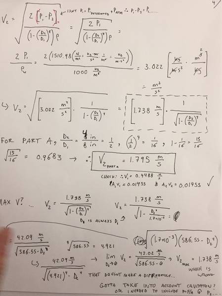

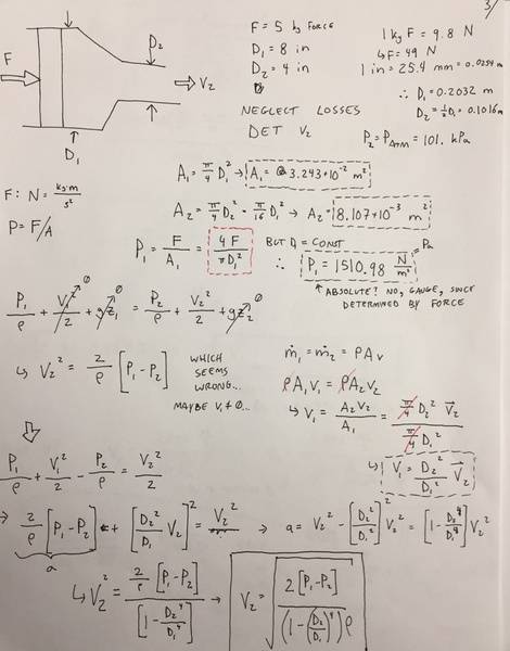

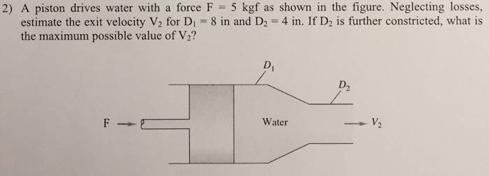

That is very good news! They take forever grading the tests and I just really wanted some positive feedback. If it's not too much to ask, would you tell me if I did the second question correctly too? There are only 2 questions so I promise this is the last one!
Please start a new thread for this. Also, please put it into Engineering and Computer Science homework forum, and use the homework template. Thanks.
