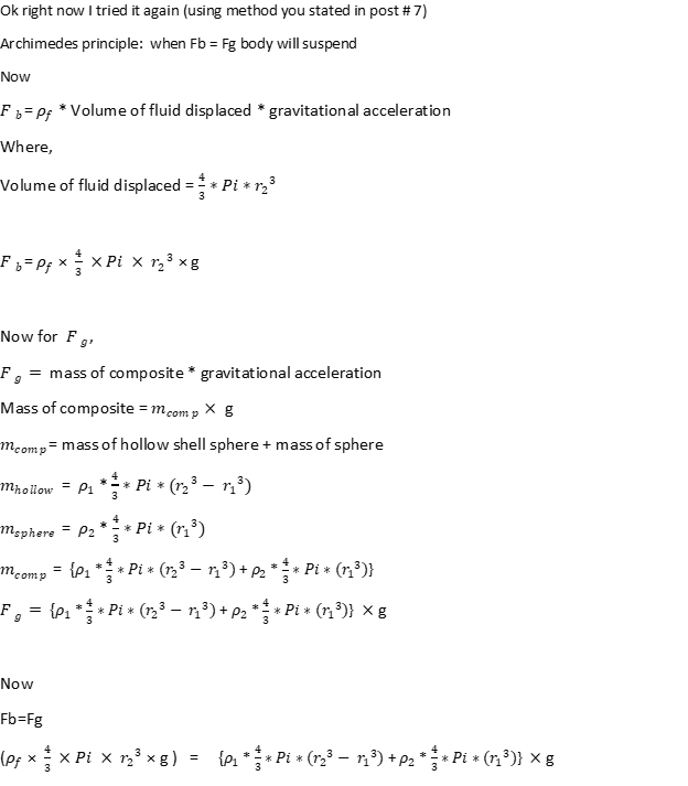

1. What should be the size of object/Particle (sphere) so that it should remain suspended (neither it should sink nor it should float)? container dimensions 30*25*25, density of fluid 0.9g/cm3 , density of particle 0.86g/cm3 , particle is coated with aluminium having density of 2.07g/cm3.(if radius is assumed then find out at what height it remains suspended in a container)2. area of sphere, area of hollow sphere , bouyouncy force, conditions for floating,sinking and suspension.3. Fb = Fg for suspended particle , where Fb = density of liquid * volume of displace water * gravitaional acceleration
Fg = mass of particle * gravitational acceleration
For finding Height we can use P = W * A * H
where
p = pressure acting on a submerged body
A = surface area of particle
H = height of suspended particle
And i m feeling difficulty in finding Pressure to determine height .

Use Archimedes' Principle.
However, there are a couple of strange things here. I would have expected one radius to be given (the uncoated particle, the coated particle, or the coating thickness) and the task wouid be to find the other two.
The other puzzle is the question about height of flotation. For that to make sense we wouid have to treat either the fluid or the particle as compressible, but we have no information on the bulk modulus of either.

yes i am using archimedes principle , i have assumed radius as well e.g if we assume that we have wood sphere coated with aluminium and radius of wood particle is 1.9cm and aluminium coating will be taken as hollow sphere having internal radius of 1.9cm and outer radius is 2cm (mean coating thickness = 0.1cm) then at this point Fb = Fg which means particle will suspend , as we have assumed radius values now we have to find height at which it will be suspended in container for this purpose i am using this formula
p = specific weight of liquid * surface Area of particle * height
for this i have value of specific weight of liquid and surface area of particle but height H and pressure acting on particle when it is in suspended state are unknown
so the issue i am facing now is how should i find that pressure to find height?

It does not seem to me that you are. What does the principle state? How have you applied it?
Where did you get this from? What do you think the resulting p represents?
I can't think of any use for such a formula.

then which formula should i use to find the height of suspended particle in a container ?

The P=WAH equation doesn't make any sense to me. What is W?
If an incompressible liquid has density ρ then at depth h the pressure is ρgh greater than at the surface. The force that exerts on a horizontal area A is ρghA. For a surface that is not all at the same depth the pressure varies across it.
But none of this is needed if you use Archimedes' Principle.
Please state Archimedes' Principle and explain in what way you believe you have used it.

As I wrote, if neither the fluid nor the body are compressible there is no way to find at what height a fully submersed body will float. If the body floats but is fully submerged it is said to have neutral buoyancy, and in theory will happily float at any depth.
In practice, everything is at least a little compressible. If the body is the more compressible then it will only float neutrally at one depth, but this is unstable. If it rises just slightly it will continue up, while if it sinks at all it will continue down.
If the fluid is more compressible than the body then there will be a depth at which it is stable.
But let's put all that aside for now and concentrate on the first part. Suppose the inner sphere has density ρ1, radius r1, and the coating has density ρ2, thickness r2. If that floats neutrally in a fluid of density ρf, what equation can you write using Archimedes' Principle?

"w" is the specific weight of fluid
Where as i have mentioned above i.e at assumed radius Fb = Fg
Where
Fb = density of fluid * volume of fluid displaced * gravitational acceleration
Fg = mass of body * gravitational acceleration
When we attain Fb = Fg body will suspend at any height in fluid which is archimedes principle... Till this point we are right because we have attained suspension but now how we will find out the height?

Ok, but have you answered the question about the size of the particle?
As I explained, and as you yourself have written, it will suspend at any height. There is no information by which to find a height.

Yes sir, i have answered the questions if i assume
inner radius = 0.024m
Outer radius = 0.025m
Then
Fb = Fg
But now we have to find the suspension height of the particle (of assumed radius)
Or let's make it simple i need to find the pressure acting on a suspended particle if these parameters are known
Density of fluid = 900kg/m3
Density of coating material = 2700 kg/m3
Density of inner sphere material = 630kg/m3
Container dimensions = 30 * 25 * 25
Radius of coating (hollow shell,outer) = 0.025m
Radius of inner sphere = 0.024m

As I keep posting, there is no way to do that. If there were any particular height then the buoyancy force would only match the weight at that height, and you know that is not so.
First, that has nothing to do with finding the suspension height.
Secondly, the pressure is different in magnitude and direction on different parts of the surface. You could calculate exactly how it varies over the surface, and from that you could deduce the net force from these pressures, but that would just be a complicated way of arriving at what Archimedes has already told you.
A question... how did you arrive at those two radii? You chose one of them arbitrarily, right?

Ok what first i did is i have assumed that i have a solid ball having some radius, with the help of that radius i calculated volume , then with density and volume i found mass of that ball
Then i used
Fb = Fg
Till this point the values of these two doesn't comes equal to each other, so now i have to etract some mass from that solid ball and mass should be equal to that with the help of which we attain equality between boyouncy force and gravitational force , as we are not just extracting mass we are not changing its volume so our Fb remains same but Fg changes
And for that i have solved it number of times
At the end i reached at some value of radius of mass to be extracted from that solid ball
After extraction of mass i have now hollow shell, now i have to fill it with other materials having density of 630g/m3, and i have inner radius known , with the help of that i found mass of that added material,
Then i found cumulative mass of solid ball (having two materials, inner material of density 630g/m3, coated with other materials of density 2700g/m3)
After finding commutative mass i found Fg with the help of it and then checked for
Fb = Fg
But with this method i came close, mean i got idea how should i have to solve this problem then i generated a excel sheet applied all the formulas i used and i varried the radius with the help of excel sheet i generated i found that at these radius 0.025m and 0.024m my result are same for Fb=Fg
This is how i did it

That's not a very direct method. Try the method I outlined at the end of post #7.

I tried it, but didnt found any expression or formula to go with it
In terms of the variables I defined, what are the volumes of the particle and its coating? What is the combined mass?

Aqib409 said:
Right.
It's a bit confusing the way you are using r1 for the inner radius but ρ1 for the coating density, but no matter.
There is some cancellation you can do, and regroup into r1 terms and r2 terms since these are your unknowns.
