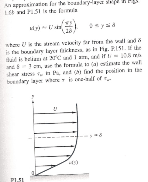

My main problem here is that I do not understand what they are asking. What is the wall shear stress? Do they mean the stress at the "floor" (or whatever you want to call it)?
If so, I am assuming I use Newton's Law of Viscosity [itex]\tau=\mu\frac{du}{dy}[/itex] since this is 1-dimensional flow.
Would the wall shear stress [itex]\tau_w[/itex] be given by
[tex]\tau_w=\int_{y=0}^\delta \tau(y)\, dy[/tex]
and then the problem reduces to finding an expression for [itex]\tau(y)[/itex]
Or am I way off here? thanks :smile:
I just found http://www.cfd-online.com/Wiki/Wall_shear_stress" . So I guess my interpretation was wrong.
So, according to this definition, I should have:
[tex]\tau_w=\mu*\frac{d}{dy}[U\sin(\frac{\pi y}{2\delta})]|_{y=0}[/tex]Is that all?

Not that anyone will respond to this (since no one ever looks in this forum), but I am assuming that if the above is correct, than part (b) is as simple as solving
[tex]\frac{1}{2}\tau_w=\mu*\frac{d}{dy}[U\sin(\frac{\pi y}{2\delta})][/tex]
for y.
Sound good? Good :smile:
So I have:
[tex]\frac{\tau_w}{2}=\mu U\cos(\frac{\pi y}{2\delta})*\frac{\pi}{2\delta}[/tex]
[tex]\Rightarrow \frac{\tau_w\delta}{\mu U\pi}=\cos(\frac{\pi y}{2\delta})[/tex]

I agree with Saladsamurai.
τw = μ×[itex]\frac{d}{dy}[/itex][Usin([itex]\frac{\pi y}{2δ}[/itex])][itex]|y=0[/itex]
so that, τw = 180[itex]\pi[/itex]μ
and τ = μ×[itex]\frac{d}{dy}[/itex][Usin([itex]\frac{\pi y}{2δ}[/itex])] when τ = τw/2
thus, 90[itex]\pi[/itex]μ = μ×[itex]\frac{d}{dy}[/itex][Usin([itex]\frac{\pi y}{2δ}[/itex])]
[itex]\frac{1}{2}[/itex] = cos([itex]\frac{\pi y}{2δ}[/itex])
[itex]\frac{\pi}{3}[/itex] = [itex]\frac{\pi y}{2δ}[/itex]
y = 0.02 m

Yes. If you actually apply the above formula, you get
τw=(μUπ)/(2δ)
Is that what you got?
