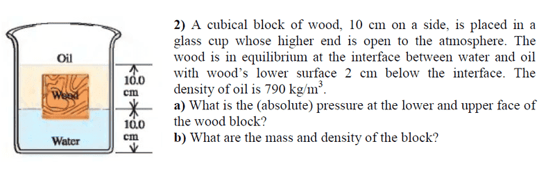

In summary, a cubical block of wood with dimensions of 10 cm on each side is placed in a glass cup with an open end. The block is in equilibrium at the interface between water and oil, with the lower surface of the wood 2 cm below the interface. The density of the oil is 790 kg/m3. The questions ask for the absolute pressure at the lower and upper face of the wood block and the mass and density of the block. Using the equations fb=p liquid * v sinked*g, p object * v object = p liquid * v sinked, and P1= Po+ p*h*g, a solution can be attempted. However, without clarification on the edge length of the wood, finding the

A cubical block of wood, 10 cm on a side, is placed in a
glass cup whose higher end is open to the atmosphere. The
wood is in equilibrium at the interface between water and oil
with wood’s lower surface 2 cm below the interface. The
density of oil is 790 kg/m3.
a) What is the (absolute) pressure at the lower and upper face of
the wood block?
b) What are the mass and density of the block?
P1= Po+ p*h*g
0.02*1 + 790*x = p wood*(2+x) =m
does it say edge of the wood is 10 cm? my english is not very good and if it is 10 cm, i can find m.
but still i have no idea about the pressure part.
my exam is tomorrow. any help is appreciated :(
here s the pic of question
