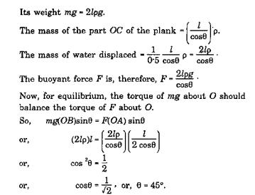

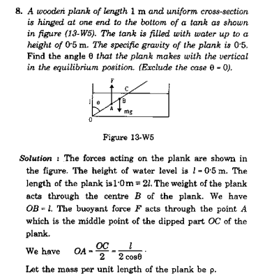

Plank has density ##\rho = 0.5##. Water has ##2\rho##.
I find it much better to use a subscript in such cases: ##\rho_{\text {water}}l/\cos\theta## (plus add an upper limit for ##\theta## for a check later on... )
thank you for your help
