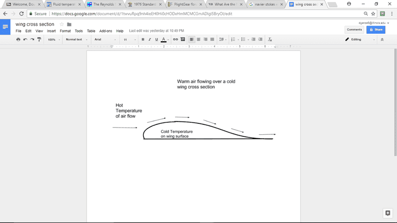

The situation is warm air flowing over a cold wing and calculating the temperature change of the air.

Your diagram file won't open in any software that I have available . Could you please convert it to .jpg or .png format and just upload it here ?
This should do it.
Likes russ_watters
OK . Thanks .
You show an aerofoil with a flat bottom and with the air only flowing over the top surface ? Is this correct ?
In any case I think that finding a solution to this problem which can be put in equation form is not a realistic prospect for anything like real aerofoil profiles1 even if you do only consider air flow over the top surface .
You could analyse a range of aerofoil sections and flow conditions systematically - one at a time - and generate a chart of results which you could then find fit curves to describe .
Anyway there are problems enough in analysing just one configuration .
Personally I would strive to set up a parametric model in CFD . There would be difficulties to overcome but I think that it could be done .
Note 1 : You may be able to do it for simplified aerofoil sections which have a very low thickness to chord ratio and very basic profiles such as arcs . You would essentially be making the approximation that the aerofoil surface was so nearly flat that it could be treated as such .
dgarza6 said:
This should do it.
Can I just say I love how it appears you have six tabs open in your browser where you researched terms people threw at you in the thread...?
Anyway, carry-on...
Likes boneh3ad
One more piece of advice, from looking at what you've posted, this problem will likely need to be solved numerically as @Nidum suggested. The easiest route would be to use some pre-packaged fluid dynamics software such as Comsol.
Really, this task has no closed-form solution and a relatively high level of fluid dynamics knowledge would be required to solve it. In my opinion, the simplest method would be to use publicly-available data about the pressure distribution of the wing section (easy to find for NACA profiles) to approximate the boundary layer. It would be relatively straightforward to do using something like Hartree profiles for perhaps a senior-level or early graduate engineering student who has taken a viscous flow course.
Using a prepackaged software is a bad idea here, in my opinion. Garbage in, garbage out. Unless @dgarza6 knows how gridding and inflow conditions work and affect the answer, using a commercial CFD package is likely to produce a bad answer, and you need some degree of fluid mechanics knowledge to be able to see the bad answer for what it is.
Either way, you would need some fairly advanced fluid mechanics background in order to solve the problem numerically on your own. The former approach has the advantage of teaching the user about fluids in the process, whereas the latter approach assumes that knowledge and would be unforgiving to someone who didn't know what they were doing. Either way, it's a relatively big task.
