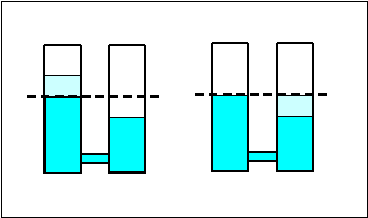

Now, changing from the original two heights to the final height involves taking a certain volume of liquid, and lowering it by a certain amount.
If you can figure that part out (the volume of liquid that moved, and the change in height for that volume), next you would find the corresponding change in potential energy. And that is the work done by gravity.

If it helps, here is an illustration of what I was saying in post #4. The idea is to figure out the difference in potential energy for the two situations.
