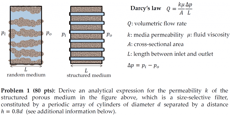

Derive an analytical expression for the permeability (k) of the structured porous medium (which is a size selective filter) constituted by a periodic array of cylinders of diamter d separated by a distance h = 1.8d
Q=k*(μ/A)*(Δp/L)
Q = volumetric flow rate
k= media permeability
μ=fluid viscosity
A=cross sectional area
L=length between inlet and outlet
Δp=pi-po
Please note that h should be 1.8d and not 0.8d

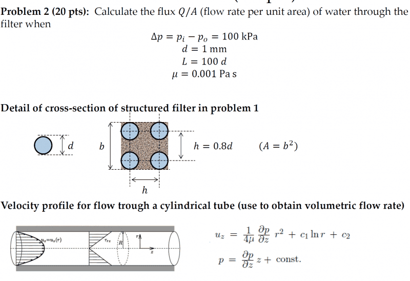

It seems like if you take a sample area of the filter such that A = b2, you'll have 4 cylindrical holes instead of what you assumed.
It appears that b = 1.8 d + d = 2.8 d, given the layout in the cross-section detail.

How I found the average velocity was taking the velocity profile
uz=(1/4μ)*(∂P/∂z)*R2+C1*ln(R)+C2
Given the boundary conditions that velocity is 0 at the wall and at its maximum at the center, I found C1=0 and C2= r2/(4μ)*(Δp/L)
Then, the average velocity reducing to Vavg= R2/(8μ)*(dP/dz)=(0.0005^2)/(8*0.001) * (100000)/(0.1) = 31.25 m/s

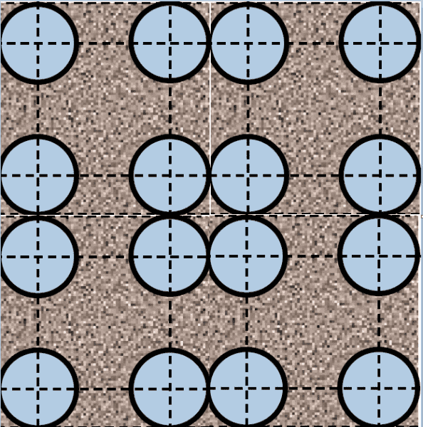

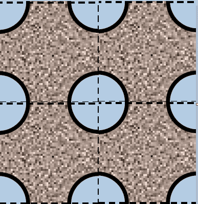

I'll try to explain my thought process on the cross section I chose as best as I can (I did evaluate both options, actually three, and chose this one as the easiest) -- let's say I took this cross section as 1 "unit" of the cylinder array - if you multiply out or copy and paste that cross section (through the center of the cylinders), the array will space itself correctly. If you took the outside of the 4 cylinders (a 2.8d * 2.8d square), and tried to build an array using that as a block, you'd need adjust for space between separate arrays. The third option I explored was to have the area past the 4 cylinders to extend 0.4d on each side (creating a 3.6d * 3.6d square) so it spaces out easily, which kind of was a more round about method of my first method. This is the only part of the problem that I'm fairly confident of -- everything else was purely a guess.
Here's a 2x2 of the filter cross section I chose:
And here's a 2x2 of the alternative:
Now -- my attempt at finding the permeability expression was to find the velocity of flow through 1 cylinder (since that is how much consumes my cross section) then find the ratio of the cylinder cross section to the filter cross section
k= Vavg*(π*d2/4)/(1.82*d2) = Vavg*π/(4*1.82)= 0.2424*Vavg which units are m/s

The statement of Darcy's Law in the OP is what's screwed up.
According to this article on Darcy's Law:
http://en.wikipedia.org/wiki/Darcy's_law
Q = -k(A / μ)*ΔP / L
which is why your units for Q were not working out. k has units of m2, BTW. The negative sign is used because ΔP = (Po - Pi) in this article, and Po < Pi.

As far as the calculations are concerned, it's obvious that the pitch of the holes in your alternative 2x2 filter section is incorrect. The layout of the filter section you chose still has the same area of holes as the cross section given in the problem statement. I don't see any advantage to working this problem using your filter section over that given in the problem statement.
