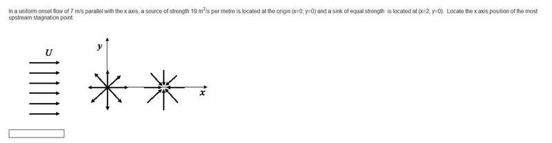

FLUIDS: Potential Flow Question -- URGENT HELP NEEDED
I need to submit this soon and I am way behind in this topic. I would appreciate it a lot if you can help me out figure the answer.
In a uniform onset flow of 7 m/s parallel with the x axis, a source of strength 19 m2/s per metre is located at the origin (x=0, y=0) and a sink of equal strength is located at (x=2, y=0). Locate the x-axis position of the most upstream stagnation point.
Diagram:
I think it will be these:
Figuring out the stream function:
Psi = (lambda / 2pi)(theta_1 - theta_2)
v=7m/s
Ugh.. please just help me out on this. It's 5% of the unit. Thanks
The velocity of the flow from the 19 m2/s source is [itex]\frac{19}{2π\sqrt{x^2+y^2}}[/itex] and is directed radially outward.
The velocity of the flow from the 19 m2/s sink is [itex]-\frac{19}{2π\sqrt{(x-2)^2+y^2}}[/itex], and is directed radially outward.
According to the problem statement, the stagnation point is along the x-axis (y = 0).
The combined overall velocity along the x-axis is U + ?? + ??. What are the ??'s?
