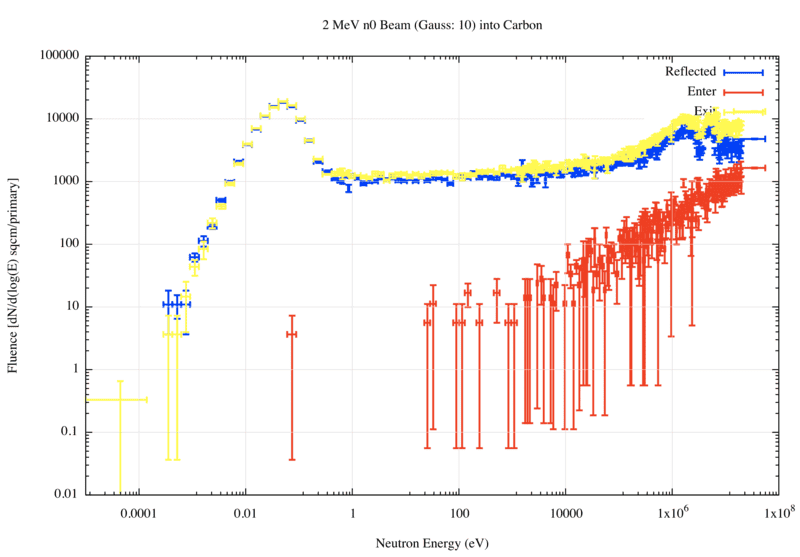

I am modeling a neutron beam passing through a carbon block. The strange thing is that when I give the beam energy a large energy spread (Gaussian FWHM set to 10) I am calculating that 3,462% of the neutrons that enter the block exit and 2,851% are reflected. n, 2n reactions are conceivable but not that much. Either I am setting up the simulation wrong or I am processing the data incorrectly.
I have been banging my head against this for a few weeks now; tweaking the simulation, adjusting my calculations, and searching around the web to try to find an answer. I can't post questions on CERN's Fluka help forum so this seemed like the best option. I really appreciate any help you can give.
I am using Fluka (via Flair) to model a 2 MeV neutron beam passing through a carbon block with the goal of looking at the percent of neutrons that pass through and the percent that are reflected. I have set up 3 USRBDX planes to count the one way neutron flux.

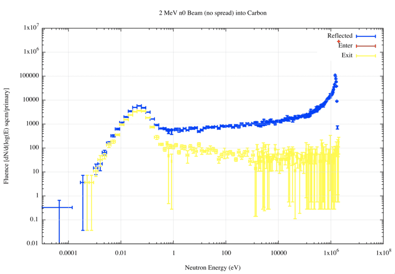

  • The first is with no energy spread on the beam. The results look plausible: 12% of neutrons exit and 83% are reflected.

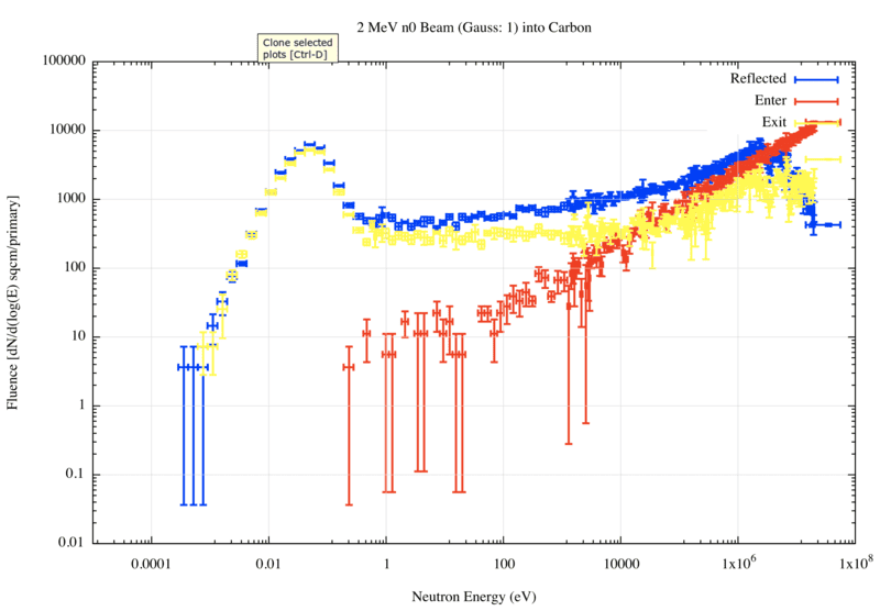

  • The second is with a Gaussian beam energy spread with the full width half maximum is set to 1. 94% of neutrons exit and 166% are reflected.
  • The third scenario is where there is a big problem. With a Gaussian beam energy spread with FWHM is set to 10. The table of the results is attached, but to summarize:
    • 3,462% of neutrons exit and 2,851% are reflected. It's conceivable that there are some n, 2n reactions but these numbers seem unrealistically high.
    • I also looked at the cumulative neutron flux from the sum.list file and the numbers are lower but still too high; 1,186% exiting and 677% reflected.
I am using the numbers from the sum.lis file to get a neutron count and calculate the percent of neutrons exiting versus reflected. I am taking the width of each energy bin for the flux, multiplying the flux times the bin width for all bins, and then adding up the results. Honestly I'm not exactly sure what the different is between the "Flux (Part/GeV/cmq/pr)" and "Cumul. Flux (Part/cmq/pr)" data in the sum.lis file, and I'm clearly not processing either correctly.

@Astronuc thank you for your help, that got me closer, somethings still not right. When multiplying flux by the mean energy of the bin the result is close to the the cumulative flux numbers, so I'm guessing that I can use either one. However the results still don't make sense to me.
When I multiply flux by the mean energy of the bin I get that the unreacted and forward scattered neutrons are 1,546% of the original neutrons, and the backward scattered neutrons are 1,041%. The results when I use cumulative flux is 1,186% unreacted and forward scattered and 677% backward scattered.
As you point out the energy is too low for n, 2n reactions so I'm not sure why we're getting almost 18 times more neutrons out of the system than we put in.
