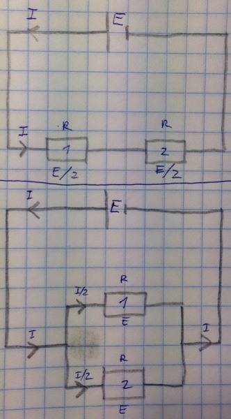

A long air-cored solenoid has two windings wound on top of each other. Each has N turns per metre and resistance R. Deduce expressions for the flux density at the centre of the selenoid when the windings are connected (a) in series, and (b) in parallel, to a battery of EMF E and of negligible internal resistance. (In each case the magnetic fields produced by the currents in the two windings reinforce.)
2. The attempt at a solution
Maybe the formula for the flux density should be B = (μ0 N I) / (2 r), where N is the number of turns on the coil, I is current and r is the radius of the coil?
Though I don't quite understand what is being given. Something like http://lrrpublic.cli.det.nsw.edu.au/lrrSecure/Sites/Web/physics_explorer/physics/lo/induction_03/graphics/IMG_4014.jpg that has two metal cables wound around it? How can they be connected in series or in parallel?
Firstly, in the question as set N is not the number of turns (which is the usual input to the flux formula); it is the number of turns per metre, so it is already in the form of number per unit length. Take care how you use the flux formula; the radius is not given and is not relevant.
To determine the current in each of the two possible configurations (a) and (b), each coil can be considered as a resistor with resistance R as mentioned in the question.

I think this should be it:
(a) B = μ0 (N1 * ((E - V2) / R1) + N2 * ((E - V1) / R2)), where V are the voltages of the respective resistors.
(b) B = μ0 (N1 * ((E / RParallel) - (E / R1)) + N2 * (E / RParallel) - (E / R2)), where RParallel is: 1 / RParallel = 1 / R1 + 1 / R2.
If the problem is as you've stated it, the windings are identical. For the serial case, the current through both is given by the total EMF over the total resistance. For the parallel case, the current through each one is given by the same total EMF over the resistance of that separate winding; although you could use the parallel resistance formula and then split up the result again, that doesn't seem very useful in this case.
In the problem as stated, the only quantities are N, R and E so the answer needs to be given in terms of those quantities. You may define additional working variables if really necessary, but if so you must explain what they are, and they should not appear in the final answer.
Likes moenste
So, in series: B = 2 * μ0 * N * (E / R), two because we have two resistors and in parallel: B = μ0 * N * (E / R1 + E / R2).
You're not being very careful. The total resistance in the series case is not R. And you've got references to R1 and R2 which do not appear in the question.

I don't see what's wrong with the series one.
I did a graph in my notebook and since we have two identical resistors then their voltage and resistance is identical or half the given one (E / 2 and R / 2).
And so B = μ0 * N * ((E / 2) / (R / 2)) for one resistor. And so in total we have B = 2 * μ0 * N * (E / R).
And in parallel: B = 2 * μ0 * N * (4E / R). The voltage is the same but the current is half of it and as well as resistance. So we have I / 2 = E / (R / 2) which gives us I = 4E / R.

In series:
Current is the same in this circuit. Each resistor has R resistance. Each resistor has E / 2 voltage.
General formula for the field is: B = μ0 n I. We know that n = N per resistor. We don't know I.
I = V / R, where V = E / 2 and R = R. So I = (E / 2) / R = E / 2 R.
So B = μ0 * N * (E / 2 R) + μ0 * N * (E / 2 R).
In parallel:
In this circuit the voltage is the same but the current is half of that of the circuit. Therefore I / 2 = E / R → I = 2 E / R.
So B = μ0 * N * (2 E / R) + μ0 * N * (2 E / R).

No, this is still confused.
The easiest way to get the current is to consider the windings separately. Each has voltage E across it and resistance R.
A more complicated way is to calculate the total current for the pair of windings, treated as parallel resistors, then to assign half of the current to each one, which cancels out the factors of 2 to get the same as the first method. You've somehow gone the wrong way with one of your factors of two.
And again, for the final answer to part (b), you should simplify the final expression.

I'm sorry, I don't quite understand what's wrong.
I = 30 A
I1 = 15 A
I2 = 15 A
E = 300 V
RTotal = 10 Ohm
R1 = 20 Ohm
R2 = 20 Ohm
My formula: I / 2 = E / R1 → 30 / 2 = 300 / 20 and also I = 2 E / R1 → 30 = 2 * 300 / 20.
B = 2 * μ0 * N * (2 E / R)

In the parallel case, each separate winding has EMF E across it and resistance R, so what's the current through it? It couldn't be simpler.
If you want to calculate the total current, that's twice the current through each winding, not half of it.
Likes moenste
You should still be able to simplify that some more!
Maybe be like: (a) B = 2 * μ0 * N * (E / 2 R) = (2 * μ0 * N * E) / (2 R) = (μ0 * N * E) / R.
I = E / R?
(b) B = (2 * μ0 * N * E) / R?
I think your answers look right now, although I don't see a need for the "multiply" symbols or the brackets.
