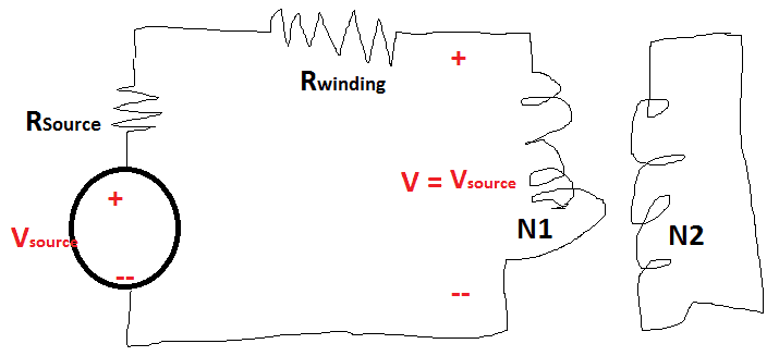

Point 1: Ok, so under shorted secondary condition: the Primary MMF will be Number of primary turns * [ Voltage on primary / (resistance of primary wire + internal impedance of voltage source) ] ?
as per the picture:
And the primary MMF is significantly greater than the secondary?

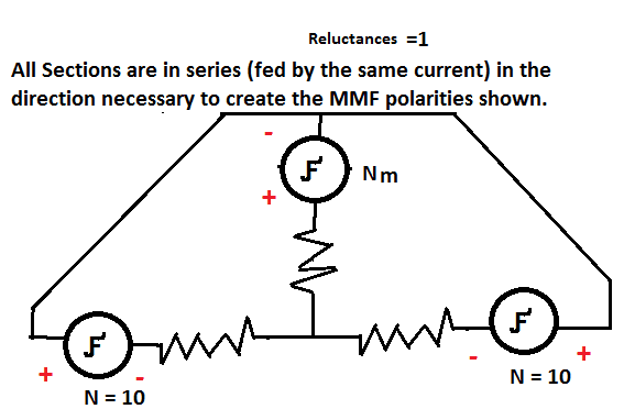

Is it fair to say that any section of core with a winding on it can be modeled as a reluctance and an MMF, irrespective of which is infront of wich, so long as they're in series next to each other?
Point 2: [below] Because I know if Nm is 10, then the flux in the middle section double the two outter sections, but what if Nm is higher or lower, what will the flux in the circuit be then? What if Nm was 5 or 20 turns?
Will the current flowing through them make the flux through all the them be the same?
as per the picture:
your red V = Vsource should read V = Vsource - I X (Rsource + Rwinding)
Significantly? By just enough to magnetize the core, flux/reluctance. By an amount about the same as transformer's no-load magnetizing current X Nprimary.
tim9000 said:
Is it fair to say that any section of core with a winding on it can be modeled as a reluctance and an MMF,...
sounds fair
I think so. mmf's in series add just as do emf's, and reluctances in series add just as do resistances.
tim9000 said:
Point 2: [below] Because I know if Nm is 10, then the flux in the middle section double <<[make that SUM OF ] the two outter sections, but what if Nm is higher or lower, what will the flux in the circuit be then? What if Nm was 5 or 20 turns?
Will the current flowing through them make the flux through all the them be the same? <<No, electrical current causes MMF. Flux is analogous to current because it flows in proportion to MMF.
Flux flows in closed loops, just like current. So you solve picture below just like a DC electric circuit using Kirchoff's laws. Sum of mmf's around any closed loop is zero, sum of fluxes at any junction is zero.
Solve it by branch or loops just as if it were an electrical circuit instead of magnetic.
Each winding is a MMF source and each reluctance is a MMF drop, flux X reluctance.
Ohm's law for magnetic circuits: MMF = Flux X Reluctance , or (Amp-Turns) = Webers X (Amp-Turns per Weber)
So traversing around either branch you'll encounter two mmf sources and two mmf drops. Assign polarities and write the sums. Kirchoff rules !
Write your KVL equations in terms of mmf and ℝ(for reluctance).
http://en.wikipedia.org/wiki/Magnetic_circuit#Hopkinson.27s_law:_the_magnetic_analogy_to_Ohm.27s_law

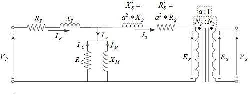

So with a TX that has a shorted secondary, there are two opposing MMFs: (Primary mmf - Secondary mmf ) / ℝeluctanceof core = Net flux
There is a large current in both primary and secondary. As you said this will result in the Secondary coil producing just enough flux to match the primary voltage. You also said "How much flux must there be? Somewhere between zero and saturation, surely." So there is a Net Flux, meaning that the Primary MMF is in some magnitude bigger than the Secondary. But surely it is more one end of the Mag curve than the other.
You said that two opposing fluxes that Net near zero will have a mag density of B near zero.
(Side observation: when a transformer saturates, the permiability drops and the impedance drops, so it draws heaps of current)
What I previously was getting at was that, since the Primary current is quite high and there would be a number of turns, then the MMFs are quite high, But B in the core is quite low, then I was thinking the impedance of the transformer would still be quite high, and the inuctance would still be quite high.
Thus it would draw a lot of VARs. I'll run through how I see it:
Fluxfrom Pri = Vpri/ [Npri turns*wfreq of supply]
this in turn makes the shorted secondary produce a counter flux of:
Nsecondary turns*[(emf= Nsecondary turns*d(flux)/dt) / resistance of secondary]
is Flux from Sec= Nsecondary turns*[(emf= Nsecondary turns*{Peak Fluxfrom pri/wfrequency of supply} / resistance of secondary]
Thus
Net Flux = {Fluxfrom Pri - Flux from Sec} / Reluctance
So since the Inductance of the TX is L = μ0μrN2Area/Length and μ depends on B which is low meaning μ is quite high, than L is quite high and X = 2wL
then the Icurrent in primary*X is a lot of Vars?
You're thoughts?
Thanks!
Good. There will be large opposing mmf's .
You're still speaking of transformer with short circuited secondary? Yes flux will be low.
slow down... you take the stairs too many at a time..
wiki has a pretty decent link... http://en.wikipedia.org/wiki/Transformer
"" impedance of the transformer would still be quite high, and the inuctance would still be quite high ""
Which impedance? Which inductance?
Remember that applied voltage divides between primary losses and counter-emf ,
so counter-emf is only that fraction of applied voltage not dropped as primary losses I X (Rp +jXp).
So your Vpri = Vapplied - I X (Rp +jXp) which will be fairly small .
i think the rest of that paragraph is okay though.

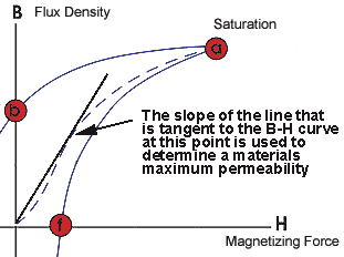

That would be XM, magnetizing inductance,
i don't think that's right.
You've made a false leap . We all want the answer to be easy, and it is but it's several steps to get there not one.
The mind will concatenate words and fool us.
μ is quite high because the core is made from good ferromagnetic material.
http://hyperphysics.phy-astr.gsu.edu/hbase/solids/ferro.html#c5

Sorry I should have been more clear, the magnetising impedance Xm and the Inductance of the Primary.
Hmm, ok, Hopefully you can help me sort out what's going on with the Counter-EMF, with regard to your diagam:
oxy.php?image=http%3A%2F%2Fupload.wikimedia.org%2Fwikipedia%2Fcommons%2Fthumb%2F3%2F39%2FTREQCCT.jpg
So the current IO through the core impedance won't change, but the counter EMF Ep is usually quite high, but with a secondary short, the counter EMF is low, so heaps of current flows through primary and secondary? (I didn't think that was right because I thought the part of Ep was the ideal transformer and no currnt flowed through an ideal transformer) but that's the only place where I see counter emf and where else could the current flow?
[As a side note let me see if I remember what the counter EMF IS: As the Vapplied resulting Current goes into the primary, causes a flux, that flux goes round and comes back through the primary coils, the coils try to produce a counter flux to oppose the origianl flux's return, via Lenz's law, and the coil does this by inducing a counter EMF Ep. Is that right?]
observe IO is in proportion to applied voltage Vp minus I X(Rp + Xp)
Xm is impedance due to primary inductance, and Rc is core loss, ohm's law applies
Yes. Counter emf is low because secondary mmf has canceled almost all the primary mmf . Not much flux but large opposing mmf's.
An ideal transformer needs no magnetizing current, that's why Xm in model is is to left of it.
But an ideal transformer has primary current equal to secondary current(load current) X turns ratio.
tim9000 said:
[As a side note let me see if I remember what the counter EMF IS: As the Vapplied resulting Current goes into the primary, causes a flux, that flux induces counter-emf ndΦ/dt in the primary , and is shown as Ep in the model above. goes round and comes back through the primary coils, the coils try to produce a counter flux to oppose the origianl flux's return, via Lenz's law, and the coil does this by inducing a counter EMF Ep. Is that right?]
Under shorted secondary, what limits current? Look at the model.
tim9000 said:
But what is/was confusing me is that usually I'd think of the graph:
remember we operate transformers below saturation.
Where's saturation on your graph?
https://www.nde-ed.org/EducationResources/CommunityCollege/MagParticle/Physics/Permeability.htm
Here's a good link for magnetizing iron.
http://phys.thu.edu.tw/~hlhsiao/mse-web_ch20.pdf
Aah, ok Let me see If I've got this straight: so on that diagram, even though it is an ideal transformer on the right, the bulk of the large current DOES flow through it and Ep which is through (Np), and is limited only by: Rp, Rs and the small counter-EMF ofcourse. And THATs where the lion's share of the Power is burnt. As the magnetising branch will only use:
(Vp - I*(Rp + Xp))2/ Xm Watts
Which is less power in the mag branch than for a non-shorted secondary because I is so much higher through the coils and thus the voltage on them detracts from the voltage on Xm.
Right so "counter-emf ndΦ/dt in the primary" is the counter emf in the secondary depending on the turns of the secondary. That's faraday and Lenz's laws I gather.
Saturation on my graph is at the top right, and I imagine opperating a shorted secondary TX is below the maximum tangent of your hysteresis quadrant. What I was saying before was that when I first started this thread I was thinking that there were huge magnetising forces (H was really high) however they're opposing each other, so NET H is far to the left of the graph, likewise for B.
If what I wrote above regarding the power is correct then I think you may have cracked it for me, this is a fundementally different way I'm viewing where the current is going than when I started the thread. THANKS
(Vp - I*(Rp + Xp))2/ Xm Watts ? look again at that model, magnetizing branch watts go into core loss Rc . Might you have meant vars into Xm ?
yes to that logic .
Secondary turns see same dΦ/dt, but we don't call its voltage counter emf.

If this is wrong that correct it, if not, then no need to reply: Just to be doubly clear, you did say that the current that flows into the 'ideal' transformer part is IP , where IS = IP/a
when the transformer is not Open circuit.
Great, again another misconception I was opperating under was that the ideal transformer had no current in it, but what you said was that the ideal transformer had not 'magnetising current' flowing through it (the mag branch was taken out so that could happen elsewhere), it will still have Ip and Is flowing through it. I'm not sure why I get muddled up like this but hopefully that'll be the last time. Thanks again Jim, have a good one!
You're quite right.
And i missed something in that model... look at the little trick they used, it's not obvious at first (wasn't to me anyway) :
They made their ideal transformer 1::1 and moved secondary side leakage inductance Xs and secondary resistance Rs over to primary side.
Then they re-named the current flowing into ideal transformer's primary winding IS !
I'd have named it Ip - (IC + jIM) , and shown IS on secondary side with Xs and Rs there too.BUT since the transformer is ideal, their relocation of secondary impedances to primary after correcting for turns ratio, works just fine.
Kirchoff tells us that my Ip - (IC +jIM) equals their IS .
So i stand corrected.
I think you have it now
good job and thanks for sticking with it.
