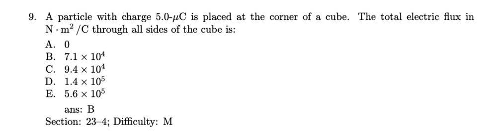

A particle with charge 5.0 micro-coulombs is placed at the corner of a cube. The total electric flux through all sides of the cube is:
A) 0
B) 7.1 * 10^4
C) 9.4 * 10^4
D) 1.4 * 10^5
E) 5.6 * 10^5
flux = q / epsilon
The correct answer is B, but I am not sure why.
I have a few confusions regarding this problem. First of all, I had thought that we cannot use Gauss' Law to determine the flux through a SIDE of a cube since Gauss' Law only works for SURFACES. How can we determine how an electric field pierces a 2D-line?
Next, if I interpret the word "sides" as synonymous with "faces," I get answer choice E.
flux = charge / epsilon
flux = (5.0 * 10^-6) / (8.85 * 10^-12) = 5.6 * 10^5 (which is answer choice E)
Additionally, if the charge is located at a corner of the cube, wouldn't that mean that there would only be flux through 3 faces of the cube? I think this because wouldn't the electric field lines from the charge be parallel to the three faces that are adjacent to the corner where the charge is located? If I am correct in this interpretation, then the total flux through all sides of the cube would be calculated using
flux = charge / (2 * epsilon)
because we would divide total flux by 2 since only 3 / 6 faces are being "pierced" by the electric field. If I follow through with this calculation, I do not get answer choice B.

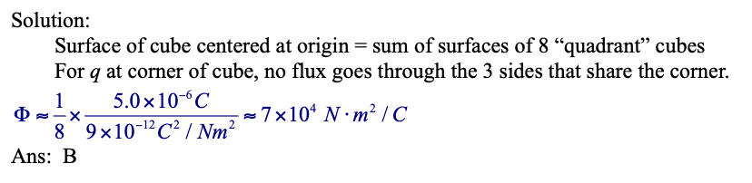

I have attached an image of the original problem as well as a solution that I found online that I am having trouble deciphering. I would be incredibly grateful for any help; I've been stuck on this problem for hours!

Gauss Law is applicable on surface which bound volume(This should be clear from derivation). First your solution is wrong since there is no symmetry argument that you can apply to lone cube. This is essential since you can't take out vector ##\vec E## from integration as it behaves differently at each surface. Coming to your doubt, note that you can imagine a big cube with centre as origin and section it in 8 equal pieces along all 3 axis from centre. Your cube is one of those 8 pieces. By placing charge at the centre of your big cube, you have made your system in which charge is placed at corner of all 8 small cubes. From here onward, symmetry arguments are valid and answer comes as you have shown in figure.

The flux through a cube of 8 times the size where the charge is at the center would be answer E. Your cube is 1/8 of that (with the other 7 identical). Hence answer B.
I don't think the exercise composer want you to worry like @Abhishek11235 in his/her last post: the faces with the charge in them simply have flux zero.
Likes Abhishek11235 and gneill
A common trick when using Guass's law is to "force" a symmetrical interpretation when you're given a situation where the charge lies on what you would otherwise be a boundary of the Gaussian surface. As others have suggested, make it so that the charge lies at the center of a larger structure that would make the overall symmetry easy to analyze.
If the charge were to be surrounded by eight identical cubical spaces, then by symmetry the one cube that you're interested in would pass 1/8 the total flux produced by the charge:
