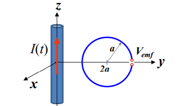

I have a circular loop with a radius of 1 m. The center of the loop is located 2 m away from a infinitely long current carrying wire, with ac current I. Find the flux in the circular loop
Φ = ∫ B ds
I've found a lot of examples with square loops, so the magnetic field in the loop will depend on both the x and y direction.
I got that Φ = ∫ uo I / π(2+y) *√(1-y2) since the magnetic field will change according to the point on the circle.
A diagram is always helpful. From your statement, it is not clear if the circular loop and the long wire are in one plane.
it's all in one plane

How did you write the integral for the flux?
Φ = ∫ uo I √(a2+y2) / (π (2a+y)) dy
My question was, do you know how that integral was derived?
