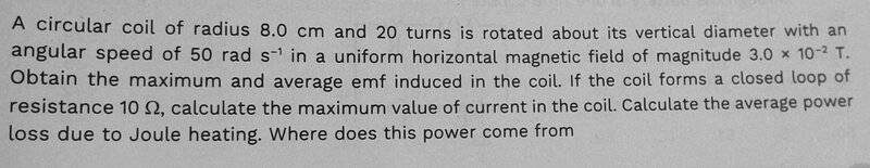

Circular Coil: ##20## turns, ##8## cm radius
Rotated about vertical diameter ##\omega=50rad\ s^{-1}##
Horizontal Magnetic Field ##=3.0×10^{-2}T##
Resistance##=10\Omega##
Find average induced and maximum induced emf, maximum current and average power loss in the coil.
Flux linked with circular coil $$\phi=NBA=\frac{\mu_○N^2I\pi r^2}{2r}$$
$$E_{max}=N^2πr^2Bω=N×0.603V$$
$$<E_{avg.}>=<N^2πr^2Bω\sin⁡(ωt)>=E_{max.}<sin⁡(ωt)>=0$$
$$I_{max.}=N×0.0603A$$
Average Power loss=$$\frac{<(E_{ind}^2)>}{R}=N^2×0.018W$$
The correct solutions are : ##0.603## ,##0## ,##0.0603##, ##0.018##
Why am I gettting an extra N? Is the emf of thin circular coil ##N\frac{d\phi}{dt}##OR ##\frac{d\phi}{dt}##
? Why?
I know it is dependent on no of turns for solenoid and in fact I got incorrect answer on a problem because of not taking E=N##\frac{dϕ}{dt}##( for a solenoid)
In an external field,
One coil has flux ##\Phi## through it.
Two coils have flux ##2\Phi## through them.
How much flux would ##N## coils have through them?
Now in a solenoid, ##N## coils produce flux ##N\Phi## through a single coil. Since there are ##N## single coils the flux linking all of them is ##N \times (N\Phi)=N^2\Phi##
Did I answer your question?

I understand that for a solenoid. Does it also hold for a thin circular coil of negligible length(width)?
Cause the answers differ in this question
If the coils could all be coincident but distinct then yes it is exactly true. (Stacked coils are one long piece of wire with only two end points)
Cause what answers differ where??????
@hutchphd In this question

My answers have an extra ##N## or ##N^2## multiplied with the given correct answers to the question.

The coils are in an external magnetic field. If there is a current through them it will generate its own magnetic field, but I think you need to read the problem more carefully.
Likes hutchphd
The entire coil of 20 turns is rotated in magnetic field, total flux linked is ##N\phi##. EMF induced per turn is ##\frac{\Delta(N\phi)}{\Delta t}## Total EMF in the coil is ##N\frac{\Delta(N\phi)}{\Delta t}##
So where am I wrong?
If the coils are generating the field, then the field is proportional to ## N ## for a single bunch of very closely grouped coils, i.e. the flux per coil is ## N ## times the flux created by a single coil.
That case is not what you have here. Instead the field comes from some external source, and the flux linked per coil is just ## A B \cos{\theta} ##.
Yes, assuming ##\phi## is the flux through one turn of the coil.
No, ##\frac{\Delta(N\phi)}{\Delta t}## is the total EMF induced in the coil. It is not the EMF per turn.
Likes Charles Link
Does this also hold for solenoid?
@Charles Link
Ok I think I get it. When current passes through the coil each turn produces its own magnetic field which contributes to the net flux of every other turn.
But here each turn got the same magnetic field and therefore same flux linked with it.

There are no "flux linkages" salient to this answer. This is a moving wire in a given external field. A "linkage" would imply that the current in one coil somehow affected that in another. So your initial equation does not apply, as previously explained by others N2 implies two interactions with each coil (source+reciever) and the source is external.. Also the average of ##sin^2## is ½ sothe energy calculation is numerically wrong I believe.
