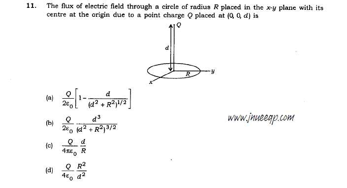

I will try to choose the correct option using the common sense instead of solving it.
As d decreases, the flux should increase. For R>>d, only option (a) and (d) satisfy this condition.
Now, for choosing between (a) and (d),
Let us consider a cylinder of radius R and length 2d placed symmetric about the charge Q.
Now, using the Gauss's law,
##2\int_{S_{circular} } \vec E \cdot d \vec A + \int_{S_{curved}} \vec E \cdot d \vec A = \frac { Q } {\epsilon_0 } ##
##\int_{S_{circular} } \vec E \cdot d \vec A = \frac { Q } {2 \epsilon_0 } - \int_{S_{curved}} \vec E \cdot d \vec A##
So, the required flux should be less than ##\frac { Q } {2 \epsilon_0 }##.
For R>2d, option (d) does not satisfy the above condition.
So, the correct option is (a).
Is there a way to get the correct option easier than this?
You could consider an extreme value of d.
The extreme value of d could be either o or infinity. Right?
If I take d as infinity, then I will have to struggle with option a and d.
If I take d near to 0, then using a small cylinder and the abv approach, it gives option a as then I can neglect the flux due to the curved surface..
But, still, I will have to use that cyllinder approach.
Is there any other easier way?
Isn't it obvious that half the flux goes each way out of the circle?
For me,
earliier it wasn't .
now it is.
Thanks for it.
