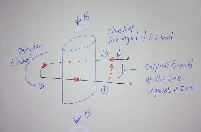

Thank you for reading my post. I can understand why a change in magnetic flux through a conducting surface would induce an emf, but how does this work when inducing an emf through a coil? How does the flux through the empty space between the wires have an effect on the electrons in the wire itself?
In the image below is a coil with a magnetic field going through the space between the wires but not necessarily through the wires themselves.

If there is a magnetic field inside the coil, but the magnetic field where the wires are is zero, then there is no way the flux through the coil can change. It is the change in flux that induces the EMF. In order for the total flux through the coil to change, some magnetic field lines need to cross the coil.

One experimental example is a long current carrying solenoid of radius ## a ##, and a loop of radius ## b ##, where ## b>a ##, and the loop is around the solenoid. For a very long solenoid, for most practical purposes, the magnetic field is completely inside the solenoid and along its axis. If the current in the solenoid is made to vary with time, the magnetic field of the solenoid, which basically is inside of ## r<a ##, will change, and the loop of radius ## b ## will experience an EMF. (The lines of flux will emerge from the solenoid and come back around, but in the vicinity of the loop, the magnetic field is very weak).

I think I might understand your argument. Why does magnetic flux through a coil induce an emf without actually touching or cutting the coil wires? From a logic and reasoning standpoint, this is a little unbelievable. I noticed that the integral form of Faraday's law does not seem to contain information about the distance between the magnetic flux (situation discussed now is coil wire) and the integral curve, but in fact if there is a separation distance between them, it must take time to transmit the information about the change of magnetic flux to the the coil wire.
So I think the information about the change in magnetic flux is transmitted to the the coil wire in the form of a time-varying electromagnetic field, and there is a certain delay time. The transmission speed in vacuum is the speed of light.
Generally speaking, when we use the integral form of Faraday's law, we assume that the distance is much smaller than the wavelength of the operating frequency, so we ignore this time delay effect.
The ideal very long solenoid has a uniform magnetic field inside it in the z direction, and zero magnetic field outside of it. Experimentally, a very predictable EMF results in a loop of wire external to the solenoid that encompasses the solenoid if the current in the solenoid changes, resulting in a change in the magnetic field inside the solenoid. For all practical purposes, there is zero magnetic field in this external loop of wire.
Faraday's law for the EMF, ## \mathcal{E}=- \frac{d \Phi}{dt} ##, which is the Maxwell formula ## \nabla \times E =-\dot{B} ##, integrated over an area along with Stokes' theorem, works with very high precision. I don't have a good explanation though for how and why the changing magnetic field is able to act very non-locally, creating the EMF in a very predictable manner.

  • #32
Charles Link said:
I interpret that as saying there arises an Es in the conductor, where Es=−Einduced. This Es will integrate along the path inside of the coil to give it the factor of N times the EMF of a single loop. In addition, external to the N loops, it must also give this same result, since...=0 ... perhaps you @alan123hk might concur
Yes, I very much agree with your previous analysis, you explained very well why the induced emf is proportional to the number of turns of the coil.
Charles Link said:
The connections of the leads to the voltmeter can be close enough together that we clearly aren't measuring the Einduced, but the integral ∫Esdl between two points must be path independent, and thereby gives the same result that it does going through the voltmeter and voltmeter leads, as it does through the coil, resulting in a very reliable voltage measurement.
As described in Feynman's lectures https://www.feynmanlectures.caltech.edu/II_22.html
"we have assumed that there are no magnetic fields in the space outside of the “box,” this part of the integral is independent of the path chosen and we can define the potentials of the two terminals"
Just like the AC voltage provided by the power company, users obtain stable AC voltage independent of the transmission line path through the transmission cables outside the power company's substation facilities.
Please note that the user does not have the means or right to go into the power company facility and put extra turns of wire on the transformer to change the voltage. :smile:

It should be noted that in some previous discussions on PF where ## E_s=-E_{induced} ## in the conductor was introduced, (by another member), one major criticism was presented of
how can a non-conservative field (##E_{induced}##) be the opposite of and basically be represented by a conservative field (##E_s ##)?
If ## \nabla \times E_{induced}=-\dot{B} ##, it should be impossible to have ## E_s=-E_{induced} ## (in the conductor) with ## \nabla \times E_s=0 ##.
It looked like it could be a valid objection, but then I later saw the explanation: When you go once around the loop (of the ## N ## turn coil) ## \oint E_{induced} \, dl=-\dot{\Phi} ##. When you go once around the same path with ## \oint E_s \, dl ##, you get ## \dot{\Phi} ## rather than zero, (even though ## \nabla \times E_s=0 ##), because you are now in the adjacent ring of the coil.
Likewise if you go around ## N ## times, you then have traversed the entire coil, and get ## \int E_s \, dl=N \dot{\Phi}=EMF ## rather than zero. Thereby, we still have a conservative field ## E_s ##, so the path integral outside through the voltmeter between the two ends of the coil also gives the same EMF, but where the coil boundaries gave us the special property where ## \oint E_s \, dl ## could be non-zero.

I have also thought about this issue, here are my thoughts
There may not necessarily be an induced electric field with curl inside the wires of the coil. If the changing magnetic flux only concentrated at the center of the coil and does not pass through the coil wire, then the induced electric field in the wire should have no curl, at this time, the electric field generated by the accumulated charge can completely offset the induced electric field, so the electric field inside the wire becomes zero.
Even if the magnetic flux passes through the wire of the coil and a curly electric field appears inside the wire, the electric field generated by the accumulated charge cannot and does not necessarily completely cancel the curly electric field. All it has to do is make the line integral of the electric field along the coil wire zero. The effect should be very close to before. The voltage across the coil remains unchanged, complying with Faraday's law. However, strong eddy currents will be generated inside the coil wires, causing greater losses. 🤔
