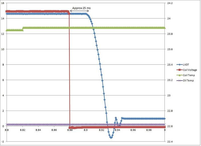

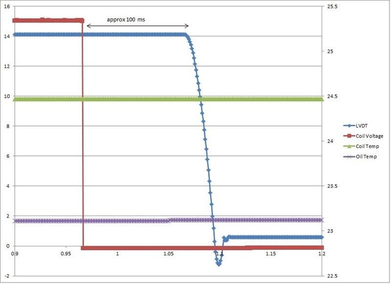

Hello,
I'm an electrical engineer dipping my foot into solenoids as part of a project here at work.To monitor the position of the solenoid's armature I have a linear pot installed. My is issue revolves around a flyback diode installed across a DC solenoid I am testing. I am low side switching the solenoid with a cheap DPDT relay. Without the flyback diode installed I see massive negative voltage spikes across V(coil) as I would expect. With the diode installed, no large negative spike occurs. Problem solved right?? Wrong, with the flyback diode installed the retract time, specifically the time after turning off the relay but before I see movement of the armature, jumps from 25 ms without the diode to over 100 ms with the diode. My customer's application is very time sensitive, they won't be happy with a +100 ms delay before the armature begins to move when powering off the solenoid. I am also assuming that my customer will want to use a FET for switching the solenoid on and won't like a 100V surge when turning it off, making the diode and something else to speed up the response time a part of their final solution. Any suggestions would be greatly appreciated! Sorry for the PDF, work copier defaults into PDFs.

Early in my career, I worked on a project for mail sorting and found the same thing. You will need to use a resistor in series with the switching path and a cap in parallel with the resistor. The cap should be of sufficient value to allow the current change to quickly snap the the solenoid in the power on state then ramp the current down to the resistor value limited amount. The resistor limited amount should be the holding current which should be much less than the initial closing current. The diode still needs to be in place, but the smaller current should reduce the holding time by a significant amount. You will need to determine the values based on your current, voltage and coil resistance.
I *think* a small resistor in series with the diode will dissipate the energy faster. Seems counter-intuitive though.
energy to be got rid of is LI2/2
rate of energy dissipation is VI
in a resistor V and I are in proportion
in a zener they are not
so a zener should give a constant di/dt until the armature starts to move
that might give you a more predictable time to open, if you need it.

First off, thanks everyone for the replies! I attached screenshots of the data plots illustrating my issue. Now down to business after reading the replies some additional information that would help flesh out the problem further:
1) You guys already hit on this but I will state it here for the record, we are using a spring return on the solenoid to return it to its initial de-energized state.
2) I am not kidding that our customer will want to PWM the solenoid when energized in order to save power. Our application is automotive and will see a wide range of temperatures, therefore ideally they will want to develop a temperature vs hold voltage profile in order to ensure it stays actuated but maximizes their power savings.
3) The diode I have in the test circuit is a RGP30GHE3/73 from Vishay. I am definitely open to a cheaper part that better meets my needs.
