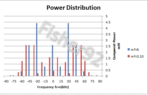

Thinking about part c for hours on end has ironically given rise to some new ideas for part b.
*I think I may have been confusing you with my queries about the carrier amplitude, or maybe I'm tripping now?
In a nutshell I have decided that there is no way I can know the carrier amplitude with the information given, the carrier amplitude is in no-way dependent on the information signal which is the only 'real' information I have. I DID NOT for some reason realize this immediately and so was stuck trying to calculate it from the ratio you were talking about (something I still do not get?). -As I write this, it seems blatantly obvious - hope I'm not mistaking now.
If I assume a 1V rms carrier amplitude in order to plot the distribution I get the carrier power J0 as
for mf = 3.33...P=(-0.36*1)^2/50=2.592mW at fc
mf =6 ...P=(0.15*1)^2/50=0.45mW at fc
...This is a bit of a problem, would this be just be 2.592-0.45 since the minus sign indicates they are not in phase?
When I do the same procedure for the sidebands I get some on the same frequency, so would these be sum if they are in phase and difference if they are out of phase? i.e if one is - and 1+ then take the difference for the power?

Hi RM, I have by and large completed the problem but as this question is worth a lot of marks I was hoping you could have a look through and see if it all makes sense.
a) Correct
mf=6 & mf=3.33
b)
My lecturer (instructor) said that if components fall on the same frequency, plot them on top of each other - so I have just calculated all of the powers and plotted them. I also set Vfc to 1V to normalise (not really normalizing) the results.
P=J^2/50
mf=6, mf=3.33 *
P(mW) *
J0,0.45, -2.592 *
J1, -0.1.568, 0.8 *
J2, -1.152, 4.418 *
J3, 0.252, 2.592 *
J4, 2.592, 0.392 *
J5, 2.592, 0.092 *
J6, 1.25, 0.002 *
J7, 0.338, *
J8, 0.072, *
J9, 0.008, *
Hope that formatting keeps..Edit: no it doesn't. It is in this format Jn,P(mf=6),P(mf=3.33)
This method kind of makes sense to me as the powers (of opposite sign +/-) on the same frequency are not going to be exactly 180 deg out of phase are they? And as they are not the same frequency they won't be effecting each other as perfectly con/destructive interference which is what summing there amplitudes is implying? I think to do this 'properly' would involve some fairly hardcore math!
My plot is just a bar graph in excel with mf=6 in blue and mf=3.33 in red... actually results in a nice looking spectrum..You can probably see what the plot will look like from the numbers?
c)
The two components co-incidentally result in the same bandwidth requirements. There are 9 sidebands for the 10kHz signal so 2*9*10=180kHz. There are 6 sidebands for the 15kHz signal so 2*6*15=180kHz.
It wants the percentage of power spilled so I can sum the absolute powers found in part b and retain the 1v rms carrier voltage to find this? The sum of the absolute powers of both signals is 21.142mW
... The total power is 2*21.142=42.284mW (with an assumed 1v rms carrier)
From the table in b the components outside of the 150kHz band are J8&J9 for mf=6 and J5&J6 for mf =3.33.
***J5 for mf =3.33 occurs at the boundary -fc+-75kHz so is it outside of the bandwidth or not? I assumed so but I'm not sure?****************
The summed power of these components is 0.072+0.002+0.008+0.072 =0.154mW
... Power spillage into the guard band is 0.154*2/42.284*100=0.73%?

Power can't be negative can it! Re the sqrt(2), I omitted it on purpose because I stated a 1V rms carrier which would negate the need for the sqrt(2)-unless I am mistaking about why it is there?
Or, there is another misunderstanding on how we treat the two modulations. I thought we decided to treat them one at a time. Anything else is even more bizarre than assuming they don't intermodulate each other.
Yes, we definitely decided to treat them one at a time AND no it doesn't make any sense to assume they don't affect (effect?) each other. The question states 'plot the power distribution of the transmitted signal' which plotting the two individual components on top of each other does- sort of... Lecturer said in regards to part b,
'View this as 2 single tones, no complicated maths required here. If 2 components happen to occur on the same frequency, plot them on top of each other.'
I'll go ahead and remove those negative powers as they are definitely nonsensical - & am I right re the sqrt(2) if I explicitly state 1V rms carrier...
RM, the table is the same as before minus the negative powers?
This is the distribution plot for the question, sorry about the stupid water mark.
I also did an xy scatter plot for the two distribution which look s a bit cleaner.
My answer for part c is the same as I did the sum of the absolute powers. Not sure if you've had a chance to look at it? 0.7% into the gaurd bands and 0% into the next channel. With the infinite amount of sidebands, would there be some small negligible spillage into the adjacent channels that I should at least mention? it would be <<<<<0.7%.

Well, he/she's still wrong about two single tones not requiring complicated math. Certainly not with betas of 6 and 3.3. He/she should have specified that only one tone is present at a time. In other words, two separate problems.
Another thing he/she should have specified is the carrier frequency. Suppose the carrier was 50 KHz. What would your spectra look like then?
Yes.
I'm not sure what 'guard band' means. Anyway, with your leave I would like to leave this thread as is. You know we're supposed to help but not completely do. I feel that you have a good grasp of the situation as is.
