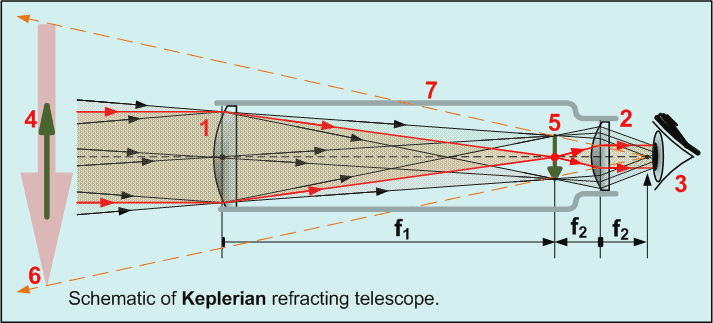

http://en.wikipedia.org/wiki/Magnification
Angular magnification — For optical instruments with an eyepiece, the linear dimension of the image seen in the eyepiece (virtual image in infinite distance) cannot be given, thus size means the angle subtended by the object at the focal point (angular size). Strictly speaking, one should take the tangent of that angle (in practice, this makes a difference only if the angle is larger than a few degrees). Thus, angular magnification is given by:
[tex] \mathrm{MA}=\frac{\tan \varepsilon}{\tan \varepsilon_0}[/tex],
where ε0 is the angle subtended by the object at the front focal point of the objective and ε is the angle subtended by the image at the rear focal point of the eyepiece. Telescope: The angular magnification is given by
[tex] M= {f_o \over f_e}[/tex]
where fo is the focal length of the objective lens and fe is the focal length of the eyepiece.
(It is assumed that the focal point of the objective is at the same place as the focal point of the eyepiece, and one looks the image from the rear focal point of the eyepiece. See picture http://en.wikipedia.org/wiki/File:Kepschem.png)
The angle subtended by the object is 7/3.84E5 and the angle subtended by the image at the rear focal point of the eyepiece is 0.01/25 =4E-4.
So the angular magnification fo/fe=22, that is fe=0.10 m.

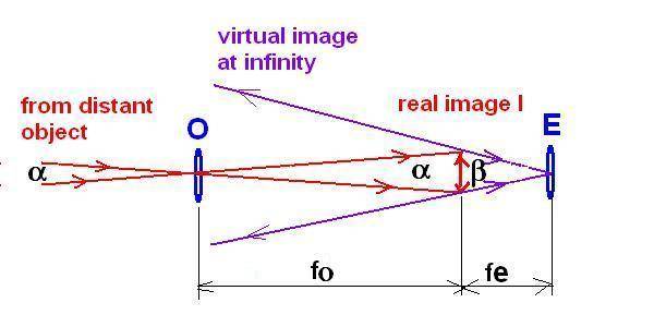

You are right, I understood at last how simple it is, and I draw a more clear picture, showing only those rays which go through the centre of the lenses and do not change direction.
The angular size of an object is the angle these rays enclose.
The focal distance of the objective is fo and that of the eyepiece is fe.
The real image of the distant object appears in the focal point of the objective lens and the eyepiece is put with its focal point at the same place, so the virtual image is at infinity.
The object of size So is at distance do from the objective lens. The size of the real image is Si.
The angular size of the object is the same as that of the image at distance fo from the objective lens.
[tex]\alpha=\frac{S_o}{d_o}=\frac{S_i}{fo}[/tex]
The angular size of the image seen from the centre of the eyepiece is
[tex]\beta=\frac{S_i}{fe}[/tex],
which is the same as the angle subtended by the virtual image at infinity,
so the angular magnification is
[tex]M_A= \frac{\beta}{\alpha}=\frac{\frac{S_i}{fe}}{\frac{S_i}{fo}}=\frac{fo}{fe}[/tex].
The angular size of the final image was given as the angle of an object of size S=0.1 mm at 0.25 m distance from the eyepiece:
[tex]\beta=\frac{S}{0.25}=4 \cdot 10^{-4}[/tex]
The angular size of the object on the Moon was
[tex]\alpha=\frac{7000}{3.84 \cdot 10^8}=1.823 \cdot 10^{-5}[/tex]
The angular magnification should be
[tex]M_A=\frac{\beta}{\alpha}=\frac{4 \cdot 10^{-4}}{1.823 \cdot 10^{-5}}=22=\frac{fo}{fe}[/tex]
that means fe=0.1 m.ehild
