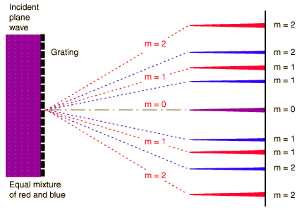

The grating here has a single spatial frequency. The picture shows the first order, but a grating also produces the second and third order. That is why a grating also produces this cool effect:
Here the light isn't monochromatic, but the grating still produces higher orders. Why aren't these shown in 4f images? Is it because they don't exist? Or is it that they do exist but they are not useful and therefore left out of such drawings?
EDIT: I just came across 'sinus gratings' and 'bar gratings'. Do the bar gratings have multiple spatial frequencies because of their binary nature (because they are effectively square waves)?
If so, that would explain a lot
Yes, the Fourier transform of a square wave has higher harmonics while the transform of a sine wave doesn't.
