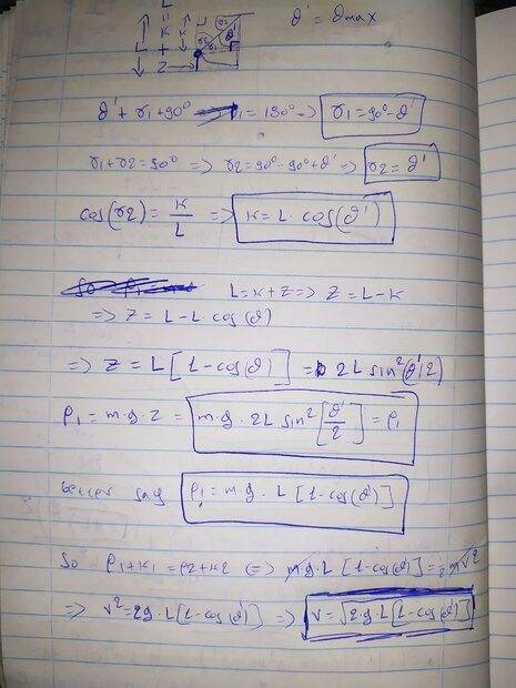

I thought of something else but I got a math error:
V at the lowest point:
##p1+k1 = p2 + k2 <=> mgL + 0 = 0 + \frac{1}{2}mV^2 <=> v = \sqrt{2gL}##
So at the highest point I now that: ##V = 0##, ##Θ(t) = Θ' = max{Θ(t)}##
and for the lowest point I know that: ##Θ(t) = 0## and ##v = \sqrt{2gL}##
and knowing from my prev calculations that ##|a| = \sqrt{g^2 sin^2 (θ(t)) + \frac{ (|V|^2)^2}{L^2}}##
so ##|a1| = \sqrt{ g^2 sin^2 (Θ') + 0 }##
##|a2| = \sqrt{ g^2 sin^2 (0) + \frac{ (\sqrt{2gL}^2)^2}{L^2} }##
##|a2| = \sqrt{ g^2 sin^2 (0) + \frac{ 4g^2L^2}{L^2} }##
##|a2| = \sqrt{ g^2 sin^2 (0) +4g^2 }##
##|a2| = \sqrt{ 4g^2 }##
so ##|a1|=|a2| <=> \sqrt{ g^2 sin^2 (Θ')} = \sqrt{ 4g^2 } <=> g^2 sin^2 (Θ') = 4g^2##
##<=>sin^2 (Θ') = 4 <=> sin(Θ') = 2 <=>Θ' = sin^{-1}(2) ##
but ##sin^{-1}(x)## is defined only for ##|x| < 1## i believe. The calculator gives an error for ##sin^{-1}(2)##
  • Sad
Likes PeroK
PeroK said:
@babaliaris not the easiest pendulum problem!
Off Topic: Yes. By the way, this is first-year university physics. There were so many students that were cheating in the past, so the professor snapped and started creating some really difficult problems. This is actually one of the easiest problems he had in exams. I'm a fifth year and I know calc 1, 2, and complex analysis and still, I can't solve his problems. First-year students are probably depressed by now :p 90% of them fail with 2-3 out of 10 (marks).
How do you get mgL for the PE at the highest point it reaches, ##\theta_{max}##?
Likes babaliaris
I thought it didn't matter, so I assumed θ=90 where the m mass is indeed L meters from the ground.
So this is a mistake?
Yes at θmax I don't know the actual height so I can't find the potential energy there.
So in order for this to be right, I have to say:
##mgz = \frac{1}{2}mV^2## where z is the height when the pendulum is at ##Θ_{max}##?

You are confusing this problem with the earlier one. In that problem the pendulum starts at the horizontal position and the initial potential energy is ##U=mgL.## Here, the pendulum starts at angle ##\theta_{\text{max}}.## What is the potential energy?
On edit: I see that @haruspex already asked the same question. Draw a triangle and find the height. It's the length ##L## minus the vertical length from the support point to the mass.
Likes babaliaris
##P_{@Θ_{max}} = mgz## where z = the distance from the ground up to the mass m, and z is uknown...
See my edited post about finding the height.
Likes babaliaris

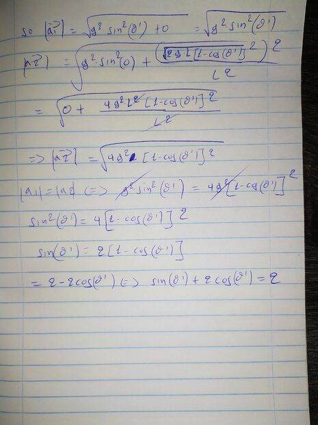

Found it ##z = L[1-cosθ']## where ##θ' = θ_{max}##

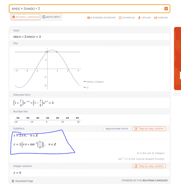

I ended up to ##sinθ' + 2cos(θ') = 2##. Unfortunately, I don't remember how to solve that. I always forget trig formulas...
Edited:
Use the trig identities of the half angle in the second equation from the bottom
##\sin\theta=2\sin(\frac{\theta}{2})\cos(\frac{\theta}{2})##
##1-\cos\theta=2\sin^2(\frac{\theta}{2})##
Likes babaliaris
Or, just square the equation$$\sin \theta = 2(1-\cos \theta)$$ and use ##\sin^2 \theta + \cos^2 \theta = 1##. That's one formula you should never forget!

All the math and physics that I did to reach in the equation ##sinθ' + 2cos(θ') = 2##
That's correct, but it's not what I'd call a solution.
Likes babaliaris
You still have to solve it and find a numerical value for ##\theta_{\text{max}}.##

I will do it tomorrow since I'm exhausted. I'm struggling with that problem for 3 days now. Never in my life, I had to deal with a problem for 3 days continuously. I'm glad that I finally figured it out!
How did great scientists try to solve a problem for years and not get crazy?
With the benefit of hindsight there is an easier way to solve this.
Just recognize it's a 3-4-5 triangle with ##\cos\theta=\dfrac{3}{5}~;~\sin\theta=\dfrac{4}{5}.##
