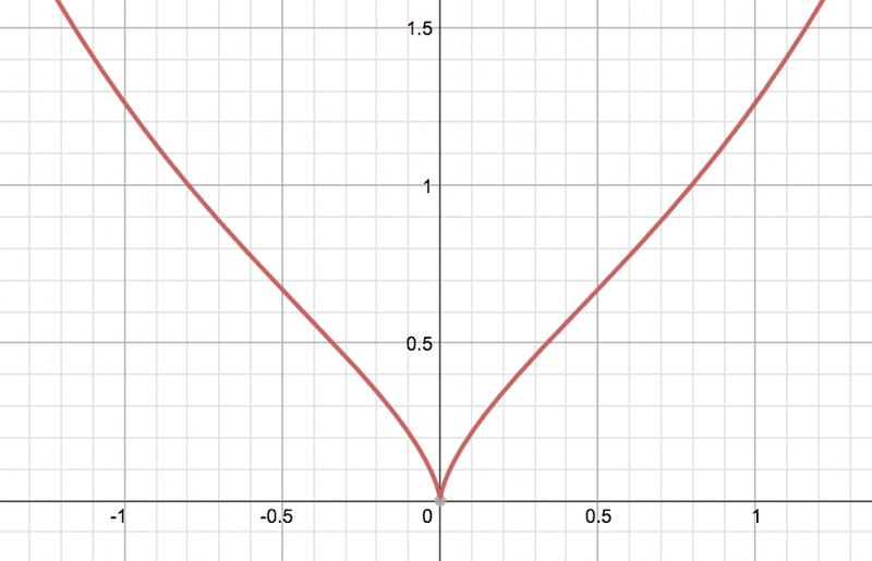

But let's look at that at a basic level and get some intuition for the role played in the collapse by the cosmological constant Lambda which we assume to be the same in the collapsing phase as it is in the expanding phase we are now in----just as we do with all the other physical constants.
We can see the effect of the Lambda constant in the shape of the scale factor curve that you get by solving the basic Friedmann equation for contraction and expansion. The scale factor a(t) tracks the size of cosmic distances compared with their present size---a(now) = 1.
When the slope of a(t) is down that means distances are contracting. When the a(t) curve is CONCAVE seen from above that means the collapse speed slows of any given distance you might be watching---the downwards slope is getting more moderate.
Or in the expansion phase, concave means the upwards slope is getting steeper.
this is characteristic of low matter density---early in the contraction phase and late in the expansion, e.g. where we are now. The present is t=0.8 on the timescale used in this figure. You can see that by t = 0.8 we are already in the concave (seen from above) increasing slope regime.
The intuitive point here is that where the density of matter and radiation is LOW the cosmological constant effect shows thru (slowing contraction and speeding expansion). But where the density of gravitating substance is high, gravity overwhelms the effect of Lambda so collapse speeds up and, after the rebound when expansion has been given an initial kick, gravity slows expansion down. This happens in the time interval from about t= - 0.4 to t= +0.4. You can probably see the convexity in that range.
According to recent Planck mission figures this changeover from deceleration to acceleration happened (on this timescale) at around t = 0.44. But I just gave it as 0.4 so as not to overstate the precision. If you look closely at the curve you can see the change taking place between 0.4 and 0.5.
There is more to discuss. This curve is a solution of the Friedmann equation for spatial flat case, with the standard cosmic model assumptions about Lambda and matter content (ordinary matter plus radiation plus cold dark matter). The standard model is usually denoted LambdaCDM or ΛCDM. We can give a simple statement of the Friedmann equation and get some intuition about how the curve is generated by the equation model. I'll pause here in case anyone is reading the thread and might have questions.
