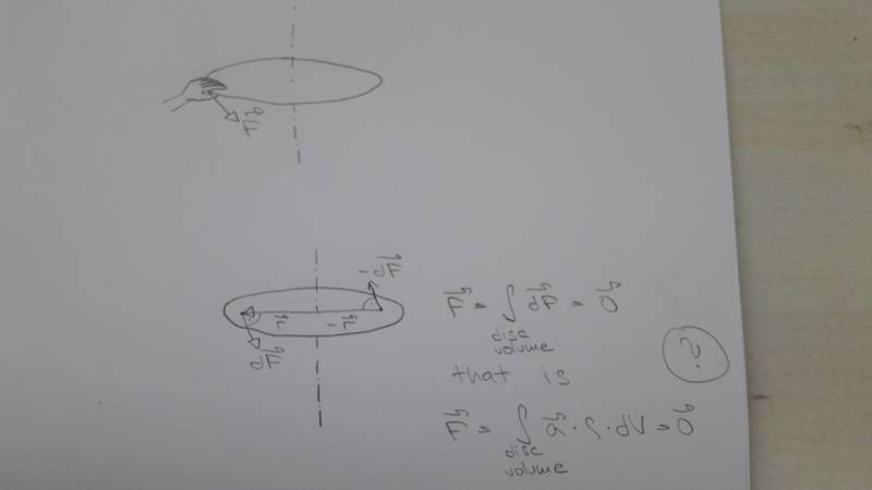

Take a disc that can rotate with respect to the rotation axis. For simplicity, let's assume that its mass is homogeneously distributed along the rotation axis, and gravity and frictional forces do not act on the disk.
In the first case, the disc does not rotate. All elements of the disk have zero force elements. The torque and angular momentum of a disc are zero vectors.
In the latter case, a man rotates the disc with his arm. This means that a person acts on the disc elements with non-zero force elements that are perpendicular to the elements positioning vectors from the rotation axis. Thus, when the disc is rotated, there is a nonzero torque of the disc, that is, the angular momentum of the disk is changing.
After spinning the disc with nonzero angular velocity, only elements of centrifugal forces that are parallel to the position vectors act on all of the disc elements, and the resultant torque of disc is zero. The angular momentum of the rotated disc is not changing, and it is a non-zero vector.
Are these considerations correct?
When I imagine that a person acts on the disk with a tangential force, I find that the elements of the tangential forces of every two points of the disc with the opposite position vectors are substracted, and the total force acting on the disk is zero. Is that so? Why?

Ok let's discuss the force distribution when rotating the disc with your arm:
But from my experience arm muscles should do nonzero mechanical work dW=F*dl when rotating disc so the overall force could not be zero from this point of view.
Let ##A## be a body fixed point. Then
$$\frac{dW}{dt}=(\boldsymbol F,\boldsymbol v_A)+(\boldsymbol\omega,\boldsymbol M_A);$$
here ##\boldsymbol F## is a net force applied to the rigid body;
##\boldsymbol v_A## is velocity of the point A;
##\boldsymbol\omega## is angular velocity;
##\boldsymbol M_A## is net torque about the point A.
Now for the point A choose the center of your disk
