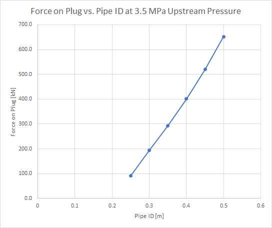

But my concern is that the method applied to calculate the force acting on the plug does not seem right.
Let me give this example, if we were to fix a plug in a large enough pipe or channel where the upstream and downstream pressures around the plug are equal, there should still be a force acting on that plug simply because there is flow striking the face of the plug (like putting your hand in a flowing river or out of a car window).
Now, if I were to change the size of the pipe or channel to be bigger or smaller while keeping the upstream fluid velocity the same, the force acting on the plug according to the example would still change! And that is my problem.
Take a look at the equation they've used in the example.
A1 is the area of the pipe and A2 is the area of the annulus. The force calculated makes sense if I'm trying to figure out the forces acting on the fluid in the control volume but not on the plug alone. The formulation of the equation states that the area of the pipe alone (A1) will change the force acting on the plug even if I hold the fluid velocity (V1) the same.
It's like the textbook is telling me that if I put my hand in two rivers with the same fluid velocity but with different widths, then I would feel different forces which doesn't make sense.
In both case I should feel the same force since its the same hand and same fluid velocity--it shouldn't matter the width of the river.
It makes sense to me that we take the force acting on the plug due to striking flowing fluid to be as follows.
With the second equation, no matter the size of the pipe or channel surrounding the plug, all that matters is the fluid velocity striking the plug and the size of plug itself.
This would agree with the rivers analogy.
I hope this clarifies my concern with the example's equation as I find it to be misleading.
So, is my line of thinking correct? Or have I assumed something incorrect here?Thanks,

What are the results you get regarding the force ,if you keep updating the ##p_1## pressure (which will become smaller as diameter gets smaller) whenever you change the diameter of the plug?
I think the second equation you wrote and which resembles greatly the equation ##F=-kv^2## is correct only when you have the plug completely submerged into the stream, but in the example in post 1, we have fluid from one side of the plug, and air from the other side of the plug. I think that's the key difference.
Likes ykh-1992

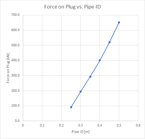

Delta, I think you're right about the plug being half-submerged.
But allow me to continue to demonstrate with one more example just to be sure.
Here I'm changing the diameter of the pipe such that the upstream velocity and pressure remain the same.
Since the plug diameter, the striking fluid velocity, and differential pressure across the plug are the same, I should expect the force acting on the plug to be the same as well.
However, the equation from the example tells me that the force should increase which is against intuition.
I anticipate the graph below to remain constant over pipe ID but this is not the case.
Based on the graph above, if I put my hand out of a car window driving at 40 mph, I will feel more force in an open road compared to the same scenario inside a tunnel.
Is this result sensible?Thanks,

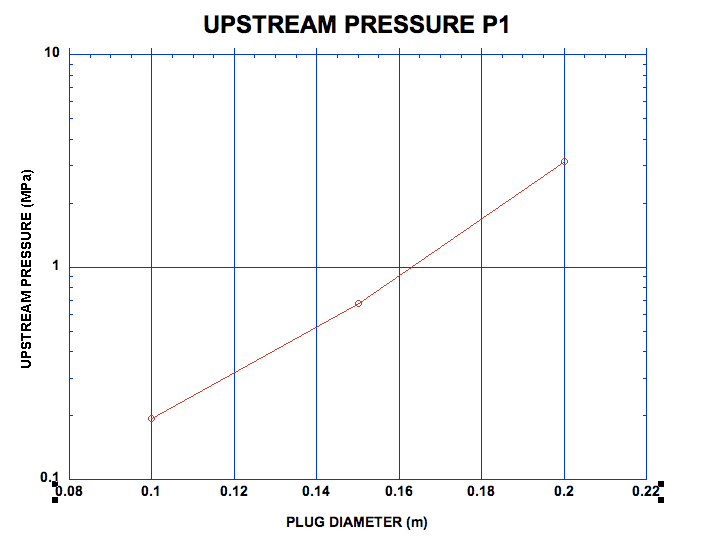

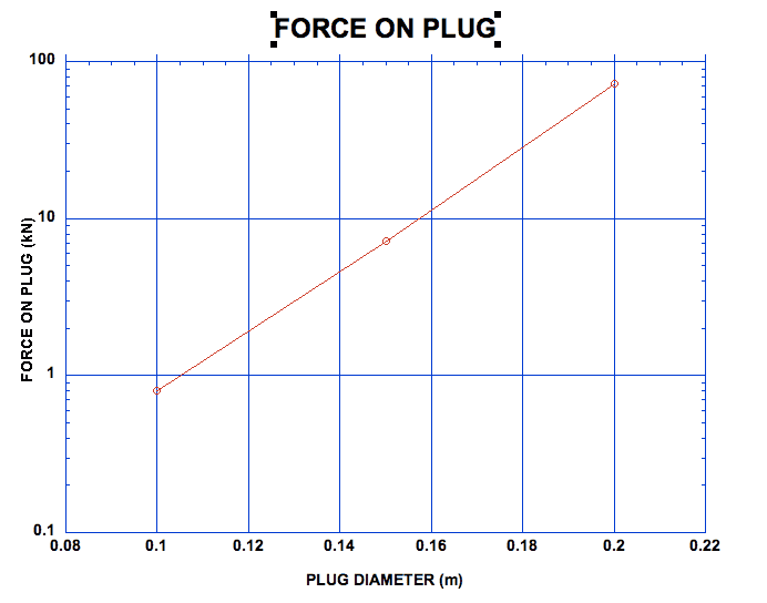

If you put your hand or an object in a stream of inviscid fluid, inviscid flow theory predicts that the drag force on your hand is zero. For example, flow of an inviscid fluid past a submerged sphere or cylinder will be such that the pressure variations on the back side of the object exactly match the pressure variations on the front side of the object, so that the net force is zero. The drag equation that Delta^2 wrote only applies to fluids that have non-zero viscosities (including gases such as air). The reason that the drag is non-zero in a viscous fluid is that the fluid velocity must go to zero at the surface of the object, due to the non-slip boundary condition. This produces asymmetric distribution of pressure from front to back on the object in addition to producing shear drag on the sides of the object.
That being said, if the flow is inviscid in your problem, then two simultaneous equations apply for determining the two unknowns, upstream pressure and force on plug:
$$p_1=\frac{1}{2}\rho v_2^2-\frac{1}{2}\rho v_1^2\tag{1}$$
and
$$F_{plug}=p_1A_1+\rho (v_1^2A_1-v_2^2A_2)\tag{2}$$
subject to the constraint that $$v_1A_1=V_2A_2=Q$$
Eqn. 1 is Bernoulli's (mechanical energy balance) equation and Eqn. 2 is the macroscopic momentum balance equation.
See what you get if you solve these two equations to determine the force on the plug. You will find that the force increases as the size of the plug increases. Please share with us your graph for that.
Likes ykh-1992

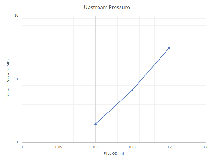

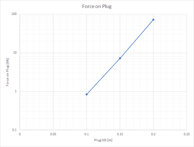

I've tried figuring out the force acting on a fully submerged plug using inviscid theory and when the net force came out as a zero, I thought I was doing something.
Here are the charts using eqs. 1 and 2.
So then I would like to ask, how does one go about calculating the forces acting on a fully submerged body in a pipe with viscous fluid? (similar to the plug example but fully submerged)
If I understand this correctly, there are two forces to account for: 1) momentum change, 2) pressure differential.
Did I get that right?
