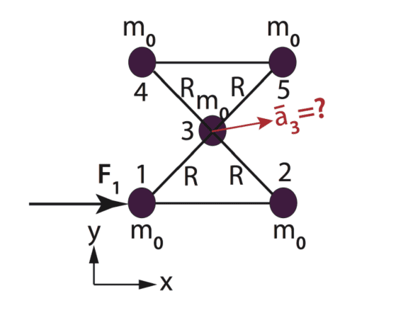

Force Acting on a System of connected masses
In summary, the problem involves finding the acceleration of point 3 in a system placed on a frictionless table with 45 degree angles and rigid connectors between masses. The suggested approach is to use the sum of forces on mass 1 and find the reaction along beam 1-3, but this is not the correct approach. Instead, the center of mass of the structure can be used to simplify the problem, as the structure will accelerate to the right and undergo counter-clockwise angular acceleration. The axis of rotation is on mass 3 and rotation is irrelevant. Using Newton's third law, the time derivative of the linear momentum can be determined, and by extension, the acceleration of point 3. The correct solution is a3 = F
Feodalherren
605
Find a3. Assume that the system is placed on a frictionless table.
Assumptions: 45 degree angles and rigid connectors between masses.
So my first thought was just to sum all the forces on mass 1, find the reaction along 1-3 and use that to find a3, is that the correct approach? I.e. the reaction in beam 1-3 divided by the total mass of the system is the solution.
Sum of the forces in x:
mAx = F1 - R13 - R12 Sin45
mAy=R13cos45
were R12 is the reaction along beam 1-2 and R13 is the reaction along beam 1-3. But then I'm stuck, and I'm also not sure I'm approaching this correctly, perhaps I should use T=Iα somehow?

No. Mass 3 will also have forces acting on it from the other connectors.
Hint: The fact that mass 3 is the centre of mass of the construction makes this problem particularly simple.

Good plan: the structure will accelerate to the right and will also undergo counter-clockwise angular acceleration. Where will the axis of the rotation be ?
Likes Feodalherren
The axis of rotation is on mass 3.
Hint 2: Rotation is irrelevant.
Also, the axis of rotation depends on the current velocity and angular velocity of the structure.
Likes BvU
Hmm... I don't know then. I can't use conservation of angular momentum since there's a force acting on the object... I'm lost, I need more help.
Can you give an expression for the total linear momentum of the structure? What is the time derivative of this momentum?
Well the total linear momentum is just the total mass multiplied by the velocity of the COM but I don't know the velocity. The time derivative of the linear momentum is F=ma?

The time derivative of the linear momentum can be determined using the formula F=ma, yes.
##\frac{dp}{dt}=\frac{d(mv)}{dt}=m\frac{dv}{dt}=ma=F##
What is the time derivative of the velocity of the center of mass?
Same thing... The derivative of the velocity is the acceleration, the only thing that is different is the mass, which is just five times m0. I still don't get any Y-component for the acceleration.
What do you mean "same thing"? What is the first derivative of the velocity of the center of mass? Answer the question.
Why would you expect a y component for the acceleration?
Are you picturing the force as an invisible hand moving rightward and pushing on the structure? And then picturing the structure rolling up and off as the hand continues in a purely horizontal path? That would be an incorrect mental picture. Better to picture a smooth wall pushing at the indicated point without resisting any resulting upward or downward deflection. [Or take the formalist approach, close your eyes and see where the math takes you].
dVcom/dt=a3 ... That's what I mean with "same thing".
Because of the way that the vector is drawn, it has a slight y-component to it.
Otherwise a3=F1/5*m0

It would be good if you would have filled in your reasoning for that. Something along the lines of:
Point 3 is located at the center of mass of the structure. Accordingly, the velocity, position and acceleration of the center of mass are the same as the velocity, position and acceleration of point 3. The two are interchangeable.
By definition, acceleration is the first derivative of velocity. So the first derivative of the velocity of the center of mass is equal to the acceleration of point 3. That is to say that it is equal to "a3".
That is all true and correct. But is not the answer I was hoping for. What is the acceleration of the center of mass in terms of the given's of the problem? What does F=ma tell you?
Yes, it does. Can you tell us by pure force of reason whether that detail in the drawing is correct or incorrect?
[Repairing formatting, that's ##a_3=\frac{F_1}{5m_0}##. Written as you have it, conventional expression evaluation rules would multiply by ##m_0## rather than dividing]
Indeed. What is wrong with that answer?

That's what I'm trying to find out :).
Force equals mass times acceleration...? Not really sure what you're going for here.
Well my first line of reasoning is that there can't be any acceleration in Y since there are no forces acting on the system from the Y direction. However, I assumed that I was missing something since the vector is clearly drawn with an y-component.
I have no idea. I'm literately out of ideas now. This problem looks trivial but I'm missing something. There is no friction and rotation is irrelevant so... It should be easy but I can't figure out why the acceleration of the COM isn't ##a_3=\frac{F_1}{5m_0}##.

You are trying to find acceleration. You know force. You know the mass. You have the formula F=ma. It is just that simple.
Yes, it is drawn that way.
Sometimes drawings are wrong. Sometimes drawings are wrong on purpose. In this case, the drawing is wrong. Your reasoning that there cannot be a Y acceleration without a Y force was spot on.
Isn't it?
Likes Feodalherren
So wait, now I'm confused, the answer is or isn't ##a_3=\frac{F_1}{5m_0}## ..? Can it really be that trivial? I mean that was my initial answer but it just felt way too easy.
Is. Yes.
You can also see it by considering the force-torque couple acting on the structure. Translating it to the CoM, the force does not change, but the torque does. The torque is irrelevant for the acceleration of the CoM.
Likes Feodalherren

Man... I really need to stop overcomplicating things. I always end up over analyzing everything and then I crash and burn. Nothing can ever be "that simple" in my mind.
