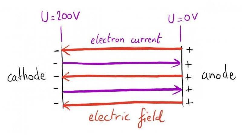

Hi everybody! I'm unsure how to tackle the following problem, hopefully some of you can give me some hints on how to do so. :)
How big is the force acting on an anode by an electron current of strength ##I=0.3##A if the electrons are accelerated with a voltage ##U=300##V?
##\vec{F} = q \cdot \vec{E}##
##I = dQ/dt##
I think I'm missing something here. I've drawn a picture of how I understand the problem, please let me know if something is wrong with my interpretation.
So the force should be ##F = q \cdot E## with ##q = -e## being the charge of an electron. My problem is the electric field, I cannot seem to find a way to calculate it! Other things I've tried/noticed:
##I = q/t## since the current is constant, so I could solve for ##t## for an elementary charge. Does that make sense? I think I'd rather have ##q = I \cdot t##, and then ##F = I \cdot t \cdot E##. When I try to find ##E## using Gauss law, I get ##E = \frac{q}{\epsilon_0 A}## but that's a dead end since I don't have the area.
Surely I am missing an equation relating ##U## and ##E##. Does anybody have a suggestion?Thanks a lot in advance for your answers.Julien.

##F = q \cdot E## tells you the force on charge q due to it being affected by an electric field E.
Think about the problem as a stream of small, massive particles striking the anode. An analogy might be a stream from a water hose striking a wall. Each particle carries a bit of momentum that must go somewhere when the anode captures it.
Can you think of a way to determine the momentum of individual electrons when they reach the plate?

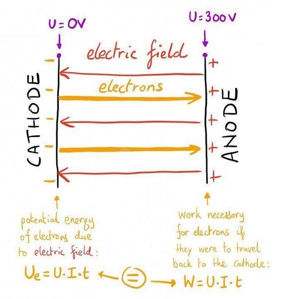

@gneill @rude man Thx guys for your answers. I think I get it now, so I give it another go and try at the same time to give it some physical sense:
So the rate at which electrons reach the anode is ##r = \frac{I}{e}##. That's how many electrons reach the anode in one second, and that's pretty clear to me.
Now the power ##P = I \cdot U = 90 W## is how much energy is delivered per second, or alternately the potential energy per second of a negative charge in the electric field created by the anode as it leaves the cathode (correct me if I am wrong here).
So as one second passes by, ##\frac{I}{e}## electrons reach the anode with an individual kinetic energy ##KE = I \cdot U \cdot \frac{e}{I} = e \cdot U##. The velocity of the electrons can be derived using ##KE = 1/2 \cdot m_e \cdot v^2## which yields ##v = \sqrt{\frac{2 \cdot KE}{m_e}}##. The momentum of each electron is then ##p = m_e \cdot v = m_e \cdot \sqrt{\frac{2 \cdot KE}{m_e}} = \sqrt{2 \cdot e \cdot U \cdot m_e} = 9.36 \cdot 10^{-24} kg \cdot m \cdot s^{-1}##. Now I take ##F = \frac{dp}{dt}## with ##dp## being the amount of momentum of ##\frac{I}{e}## electrons in one second and ##dt## being that very same second, and the result is:
##F = 9.36 \cdot 10^{-24} N##.
Uf I feel like I have overcomplicated it one more time. I have attached another picture with my refreshed vision of what's going on in there. Please let me know if I misinterpreted something again.Thanks a lot for your help, it's been very valuable. I hope I got it right now.Julien.

That looks better! That last result looks good. But you need to forget the excursion into power and the involvement of rate when determining the value of the individual dp. Just concentrate on a single particle for that. Apply the rate after you have dp.
You've already presented suitable versions mixed in with all the rest over several posts. So picking out the relevant bits and discarding the rest it boils down to this:
For the KE of one electron falling through the given potential difference U, ##KE = eU##. That gives us:
##v = \sqrt{\frac{2 eU}{m_e}}##
and so the momentum of a single electron arriving at the plate is:
##p_e = m_e \sqrt{\frac{2 eU}{m_e}} = \sqrt{2 eU m_e} ##
Individually these bits of momentum are very tiny, and the current is made up of a great many of them. So we are justified in identifying ##dp \approx p_e##. Thus we let:
##dp = \sqrt{2 eU m_e} ##
Then apply your arrival rate to form ##\frac{dp}{dt}##.
