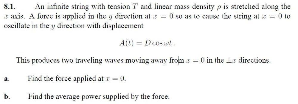

A string of tension T and linear density ##\rho## is driven at ##x=0## and two travelling wave in positive and negative x-direction had been created. Calculate the force and power applied to create the travelling wave.
I am studying chapter 8 of the book the physics of waves by Howard Georgi and I am quite confused. I read the entire chapter but I still don't quite get how to acquire the travelling wave mode of a system. Can someone check my solution to this problem but also explain how to systematically work out the "travelling wave mode" from conditions provided like this question?
##\frac {\partial^2 \psi} {\partial t^2} = \frac T \rho \frac {\partial^2 \psi} {\partial x^2} ##
##F = - T \frac {\partial \psi} {\partial x}##
Again I am really confused, but I just put the traveling wave as:
##\psi(x,t) = Dcos(kx- \omega t)## for positive x
##\psi(x,t) = Dcos(kx+ \omega t)## for positive x
Then I simply differentiated and plugged in ##x=0##
##F(t) = - T D k sin(\omega t)##
and from this
## \langle P \rangle = T D^2 k \omega sin^2(\omega t)##

The string is infinite. My greatest confusion is with the process from ##A(t) = D cos(\omega t)## to the wave function. In this case I think I am just guessing the function instead of working it out. I know how to work a standing wave function from this but not a traveling wave.

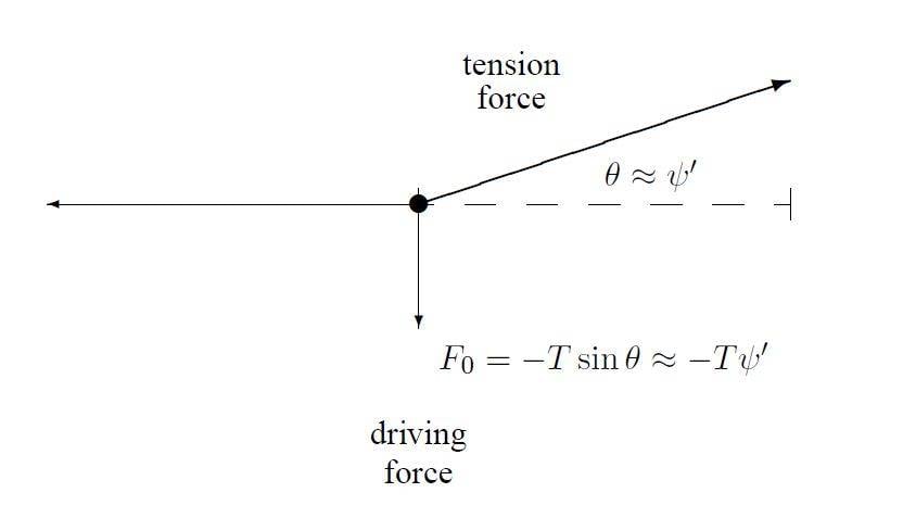

241313
for small ##\theta## ##sin(\theta) = tan(\theta) = \frac {\psi (a)-\psi(0)} {a}## for the limit ##a## approaches zero. The angle and force are illustrated in this image.
Good, but remember the driving force acts on both sides of the origin.

Ummm are they not? They are provided in the question right? Or do you mean something else?
I based that on the synopsis you typed in post #1, but yes, I see they are given in the attachment.
