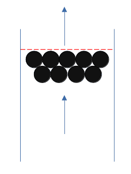

Pack of spheres? Can you give us a complete diagram of the experimental setup and data?

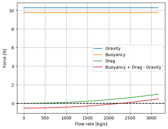

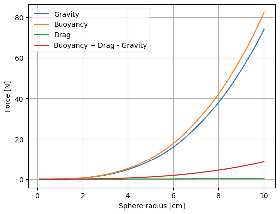

Sure, here is it. One assumption I make, to make it a bit simpler, is that the "push" from the fluid is the same for each sphere and assume a "void fraction" to calculate the velocity (v_assumed = v_fluid / void_fraction). I also attached a dummy example I made, the parameters are:
- Density of the fluid: 2000 kg/m^3
- Density of the sphere: 1800 kg/m^3
- Mass flow rate: 1000 kg/s (huge)
- Radius of sphere: 5 cm
- Radius of pipe: 100 cm
- Void fraction = 1
The drag seems unbelievably low.

yrob said:

Radius of each sphere is 5 cm? the spheres go 50 cm across the pipe? Is that red line above them holding them from accelerating upward?
The radius of each sphere is indeed in this example 5 cm.
And the red line can be thought of a grid which prevents spheres to go further.
Ok, so the red line is applying a force ##N## to the spheres in the same direction as their weight. Can you write a force balance for the spheres so we can see what we can figure out, or try to determine what information is necessary to (perhaps) fill in the knowledge gap ( i.e. ##N##)?
Thank you for your patience with me.
I see that there is a lot of confusion with this problem. Let me disclose some more information.
These spheres are packed naturally with buoyancy. However, now, the flow in the pipe is turned on (let's say, with a pump). The packing should be tighter. I am trying to apply an extra force on each sphere to make that happen. In practice they are not immobile, since I need them to have a tighter packing, but since the displacement is probably very slight, and that the velocity will be much lower than the velocity of the fluid, I was assuming fixed spheres.

If a sphere(s) are unrestrained and are not accelerating in the flow, then the force of drag can be found immediately.
In that simplified moving case then, the chart with dummy values I sent would be correct? I am highly surprised that 1 ton per second flowing in this pipe would not be enough to fight gravity (if we do not account for buoyancy, with equal fluid and sphere densities).
Water floats in water. There will be no drag force necessary if the spheres are the same density as the water.
Maybe I am misunderstanding your answer, I apologize.
Let us say that now the sphere is slightly denser than the fluid.
The push that I am calculating (from the drag formula above) is almost negligible, and would need several tons of fluid flowing every single second just to fight gravity. I feel like there is something missing.

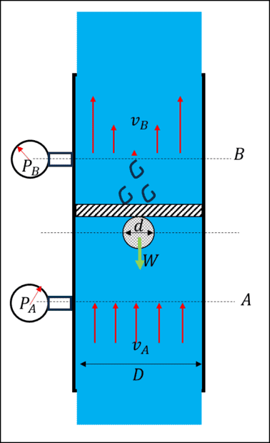

We start from a sphere immersed in a pipe filled with a fluid (we could assume we insert it at z=0), then turn on a pump which will make the fluid flow vertically. If the formula I am using is correct and using a slightly denser sphere than the fluid (1900 vs 2000 kg/m^3), the amount of fluid I need to fight gravity is 2.3 tons per seconds, 8280 tons per hour, this cannot be correct, right?
yrob said:
I agree with you, but I was trying to simplify the example, and did not say 0 flow.
Is the sphere constrained of not? If it is not, is the sphere accelerating? If it is not accelerating is it moving at some non-zero constant velocity or is it completely stationary w.r.t the inertial frame? Share the derived equation of motion, computations, assumptions state clearly! I'm not a mind reader.

The friction is not "resisting" motion, if anything it is providing it. Ideally if the sphere is at rest in the inertial frame than we just have:
$$ \uparrow^+ \sum F = F_d + F_b -W = 0 $$
##F_b## and ##W## you know. There are still two unknowns in ##F_d##(drag force), ##C_d## and ##v##.
If you are doing the experiment and controlling/measuring the flowrate, you are controlling ##v## such that the acceleration of the sphere is zero. Then...you may compute ##C_d##. If you are asking what ##v## is without experimentation, then you either need ##C_d## (typically a function of the velocity) or other information about pressure and velocity distribution before and after the "obstruction" (sphere) with further analysis.
So show me exactly how you calculated both ##C_d## and ##v##?
For a single sphere the cumulative data was compiled and a correlation was proposed by Clift and Gauvin for the drag coefficient which is reported to deviate from the data by -4% to 6% for ##\text{Re} < 3 \cdot 10^5## according to [1]
$$C_d (\text{Re}) = \frac{24}{\text{Re}}\left( 1 + 0.15~{\text{Re}}^{0.687} \right) + \frac{0.42}{1+ 4.25 \cdot 10^4 ~ {\text{Re}}^{-1.16}}$$
Where the Reynolds number is given by:
## \text{Re} = \frac{\rho_w v D}{\mu} ##
Using some general variables and Newtons Second Law we can write the following:
$$ \frac{4}{3}Dg \left( \frac{\rho_s}{\rho_w}-1 \right) = C_d(\text{Re}) v^2 $$
##D## sphere diameter
##\rho_s## density of sphere
##\rho_w## density of fluid (water)
##\mu## viscosity of fluid(water)
For a single sphere you could use this relationship to solve for ##v## iteratively, but this says nothing about the drag coefficient for your group of packed spheres which have an entirely different coefficient function (likely unknown), so predicting your bodies drag coefficient without properly conducted experimentation is unlikely.Reference:
[1] Engineering Fluid Mechanics, Crowe, Elger, Williams, Roberson-9th Edition.
Just an FYI. I get ##v \approx 4.3 ~\rm{ \frac{m}{s}}## using the method above for a single steel sphere of diameter ## 10 ~\rm{cm}##. So, In a pipe that is ##100 ~\rm{cm}## in diameter ( that's a LARGE pipe ), it would require a mass flow rate of about ##3.4 \cdot 10^3 ~\rm{\frac{kg}{s}}##.
I'd recommend decreasing the diameter of your pipe, and using smaller spheres!
