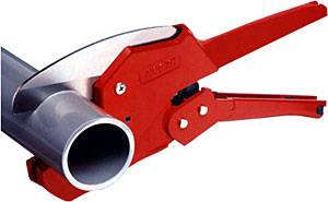

How big are the PVC pipes? You mentioned 40mm? Have you considered using a PVC pipe cutter instead of a saw? How clean do you want the cut edge(s) to be?
http://www.mccusainc.com/Tools/images/PVC-Pipe-Cutters-5.jpg
I just wish to avoid performing any debarring.
Initially that's how I was cutting them but now I just need many more so this would be a good investment for me.
