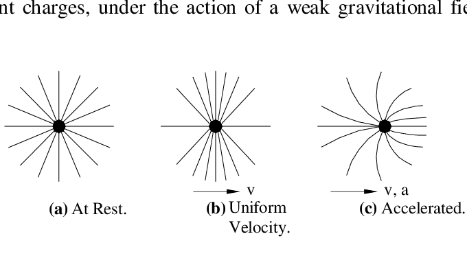

What kind of electric field is measured when charge q flies past a measuring device at speed v?
The maximum value is:
silverrahul said:
No , i think it should be E=q/4πε0r2
That's for the rest frame of the charge. If you transform the E field into frame where the charge moves, it gets length contracted, and thus stronger perpendicular to the motion, but weaker in line with the motion.
From: https://www.researchgate.net/figure/Electric-Field-of-a-Charged-Particle_fig2_2177605

A.T. said:
That's for the rest frame of the charge. If you transform the E field into frame where the charge moves, it gets length contracted, and thus stronger perpendicular to the motion, but weaker in line with the motion.From: https://www.researchgate.net/figure/Electric-Field-of-a-Charged-Particle_fig2_2177605
Thanks a lot for this . I had no idea about this, i will look it up to see if it helps
