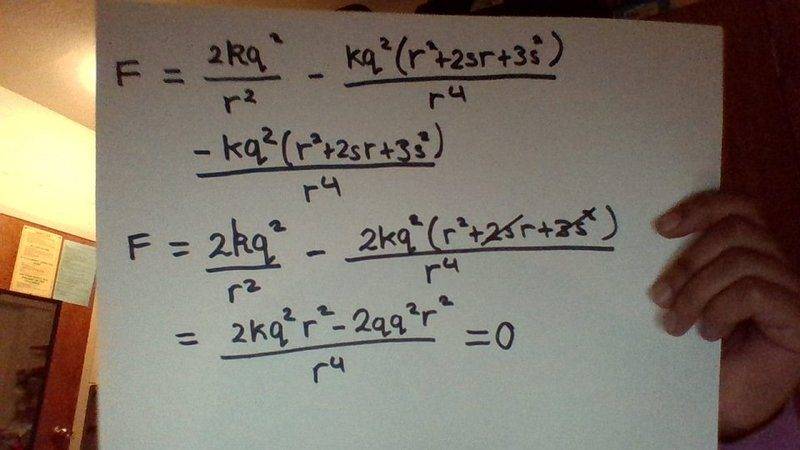

I thought I would calculate the force on each charge of the dipole on the right by using the equation above and F=Eq. Then I would add the two. For r, I'm confused about weather I should use (r+s/2) and (r-s/2).When I tried this, I couldn't find a way to simplify to the desired answer which I know is 6kq^2s^2/r^4.

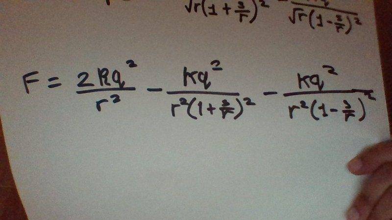

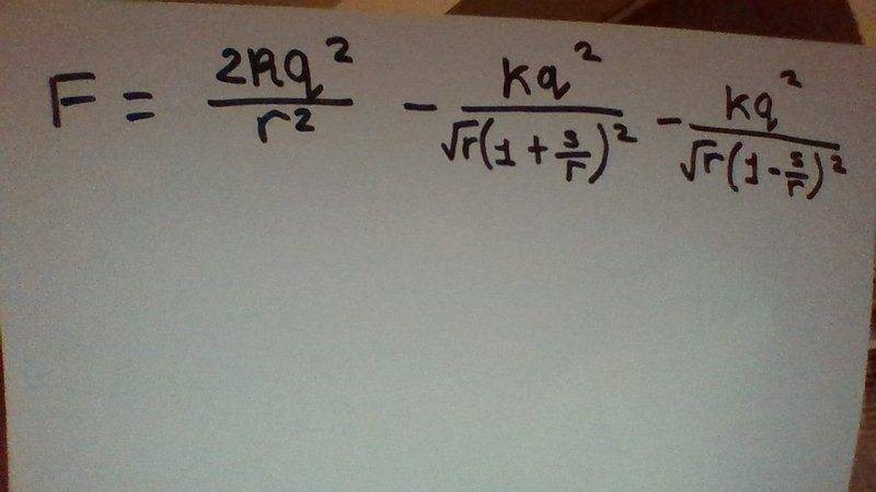

OK, this looks correct for the net force on the dipole. You need to approximate this expression using the condition that s << r; or, equivalently, s/r << 1. Can you manipulate each of the last two terms in F so that they are expressed in terms of the small quantity s/r?

made an error,

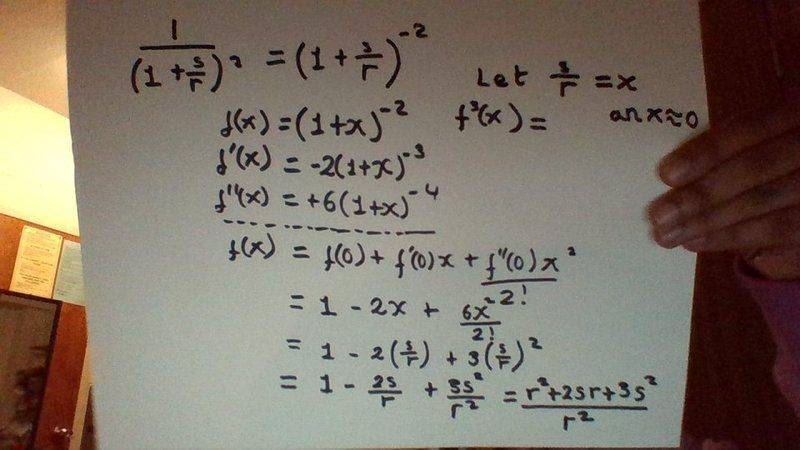

OK. Looks good. Do you know how to approximate ##\frac{1}{(1+s/r)^2}##?

unfortunately not, does it have something to do with a McLaurin expansion? I couldn't find any clear explanation online.
You're almost there. You have a sign error in the first equation of the second picture. The expansion of ##\frac{1}{(1+s/r)^2}## does not equal the expansion of ##\frac{1}{(1-s/r)^2}##.
I don't quite follow your cancellations in the second equation of the second picture.
I'll fix the signs :D. I thought that since s is much smaller than r, the terms with s In them will be negligible.
Okay so I fixed the signs and just expanded and found that it simplified to the right answer XD XD XD, thank you so soooo soooo much
