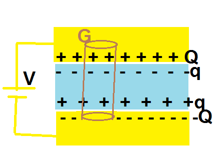

Taking the cylindrical surface as Gaussian surface and applying Gauss's law, electric field at each plate is unaffected by the presence of dielectric. Hence, the force between the plates remain unchanged.
It also illustrates that the field due to dielectric outside the dielectric is 0 here.

The Gaussian surface that you have chosen encloses zero net charge and the normal component of the electric field is zero on its faces. So Gauss's law says 0 = 0 which is always true and does not help. The field at each plate is the same as the field at a point inside the dielectric. Therefore, if you want to make a Gauss's law argument, one of the faces must be inside the dielectric and parallel to the plates, but then you will have to figure out the enclosed charge.
My personal opinion is that Gauss's law is not a good way to approach this problem. The clean way to do this is by using an energy argument. Note that the force between plates can be found from ##F=-\dfrac{\partial U}{\partial x}## where ##U## is the potential energy stored in the capacitor and ##x## is the separation between plates. Calculate the force with and without the dielectric and compare. Also note that the disembodied hand that inserts the dielectric (presumably at constant speed) does external work on the dielectric + charged capacitor system therefore the potential energy and hence the force cannot stay the same.

I was thinking that the Gaussian surface does not enclose the negative free charge on the bottom plate. Maybe @Pushoam can clarify.

I went by the drawing that shows the bottom Gaussian surface in the yellow region of the conductor. As long as that is the case, the field at the surface is zero. If the bottom Gaussian surface at the interface between conductor and dielectric, the electric field is discontinuous right at the surface.
I don't think that it is possible to have a Gaussian surface bottom face inside the conductor and at the same time exclude the negative free charge which is right at the interface between the conductor and the dielectric. If the bottom Gaussian surface is right at the interface, is the free charge enclosed or not enclosed? Is the electric field, which is discontinuous right there, zero or non-zero?
The capacitor is connected to a battery. You don't need Gauss' law to show that the field inside the capacitor stays the same. Is is just ##\Delta V= E d## and neither voltage nor distance change when you introduce the dielectric. But the density of the free charges on the plates increases when you introduce the dielectric so the force betwen the plates should increase. The same can de shown by by taking two capacitors with same geometry and same potential difference, one with dielectric and one without, and calculate the force by the energy method sugegsted by Kuruman, for each case.
I think it doesn't really change anything if you imagine a very thin layer of vacuum separating the dielectric from the bottom plate in the figure of post #3. The bottom surface of the Gaussian surface is in this vacuum layer, not in the conducting material of the plate.

The diagram with the Gaussian shows a battery connected. But you are right, the statement says it is isolated.
I didn’t notice the battery in the diagram. It shouldn’t be there. Thanks.

The free charge at the bottom plate is not included and the field there is non-zero. That's why there is force on the bottom plate due to top plate.

Here is the Gaussian surface I was talking of. It includes charge of upper plate and upper part and lower part of dielectric. Electric field due to the dielectric outside the dielectric is 0. Hence, the electric field at bottom plate (which is outside the dielectric) is only due to upper plate, not the dielectric.
The bound charges and the free charges are not mixed with each other. These are divided by a surface (which is invisible here as I cannot draw it here). The bottom part of my Gaussian surface is here.
Now, as this surface is close to the facing surface of bottom plate, the electric field on this surface is close to the electric field acting on the charges of bottom plate.
Just above the bottom part of Gaussian surface, ## \vec E = \frac{\vec E_0}K## and just below the bottom part of Gaussian surface, ## \vec E = \vec E_0 ##. The bottom plate is just below, hence here, ## \vec E = \vec E_0 ##. The bottom part of Gaussian surface is at the point of discontinuity.
This approach shows that the force remains same in both cases (1) and (2). Which mistake am I making in this approach?
